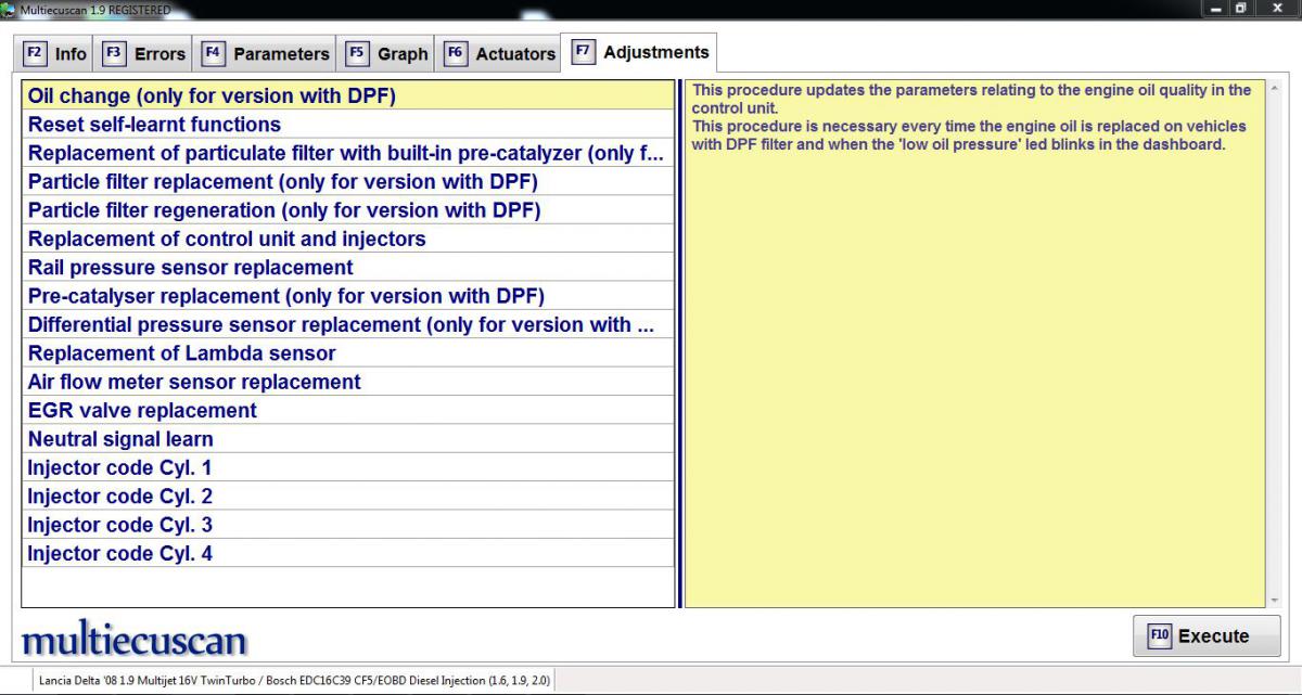

Which engine do you have? If it's a diesel you need to do it "properly", see attached photo. Either way you can enter the milage when you changed the oil, and display the total number of oil changes. To do this you can use MultiECUScan, worth every £. I do all maintenance myself, as there's no Lancia dealer in Norway, the program is very helpful.

When trying to reset the light, did you go to: "Engine", "Adjustments", mark "Oil change" and hit "Execute"? I think that's the right way to do it. That's supposed to work with the ELM-cable, I think.

Hey I got it working, thanks!
Basically I was going into the Reset Service options rather than Engine options. And any of the oil reset settings were not working. However the one you said worked straight away. Feels like I got a bit more power coming through too at the top end.
I guess the other options probably work on cars without a DPF filter or maybe just totally different models?
