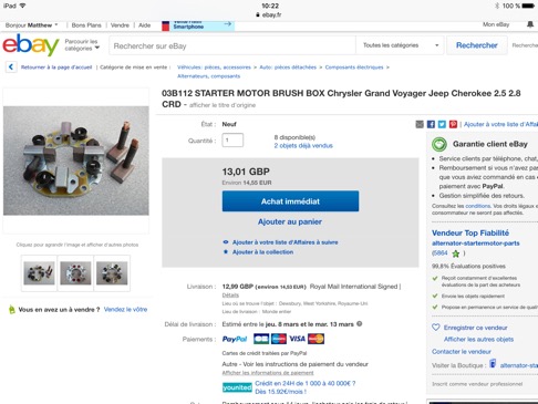

So the brushes have to be replaced ,is it do it yourselfable ?
Edited by frogland
It depends how good yoy are with mechanics...by the time you find the brushes you take it to a local mechanic, I usually pay £10-20 depends. If you don't get them right it can damage the rotor, I prefer taking it to someone that does this for a living.
Also keep in mind that playing with the negative (earth) it creates high inrush current that can damage the starter, if not damaged already.
