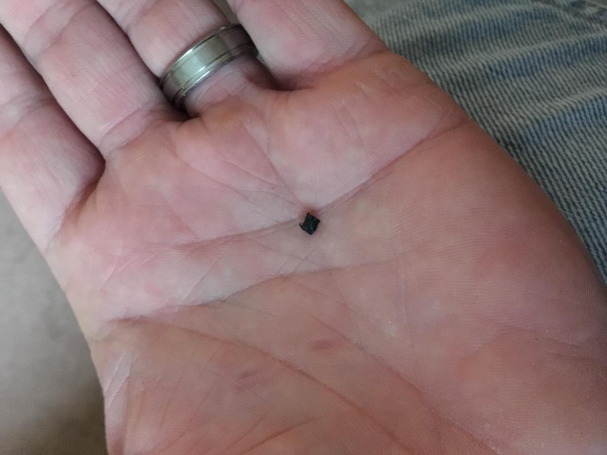

Do this with the headlight switch in the off position. Once the switch is removed, grab hold of the spline that the switch fits over, and turn it anti clockwise. Youve then turned the automatic headlamps on. You arent able to turn the swich to this setting when the switch is in place, because of a little plastic nipple. You can see this to the lower right of the spline. Cut this off with a craft knife and replace the switch, and hey presto they work a treat.
