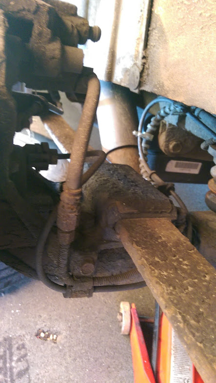

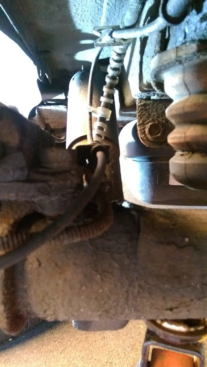

This is the curious one, "Brake hose twisted Nearside Rear [3.6.B.4c]". Now I checked as first thought had I put a caliper on twisted or somehow twisted the pipe, but no, perfectly straight, then I started looking from underneath as per how the tester would have seen as it's on ramps, and the only thing I can think of is he spotted how the OEM brackets cause the pipes to go from beside each other to above/below each other, which of course causes the pipe to 'cross'. I took some photos, as I'm guessing most others here will never have heard/seen this before!
In photo two you see as one brake cable goes over the other due to how the brackets are. To me this is factory standard, so not a failure point?
Anyway, when I took it in (I'd replaced the discs, pads, readjusted headlights and improved the park brake), I didn't say a thing, left him to do the retest and waited for it failing on this again and then having the argument, to my surprise it passed this time.
So just one to watch for as I don't believe that should have been a failure reason, but at the same time a couple of picky points, I think he was having an off day (It was last MOT on a Friday, he was running late, etc).

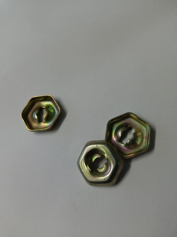

Funny you mention that @@gordy but that's the problem I faced, mine aren't great and then I found the push pins had pulled through the rear backplate completely due to corrosion. I also don't think the springs are very good on these pins as you seem to almost 100% compress them to fit, so there is way too much force involved.
I changed the spring on mine to a smaller coil and found another vehicle used similar diameter pins but with a slotted washer that went at the back to secure them, using those and it works a dream now fitting-wise.
Here are the ones I found, I flattened them and they fit nicely at the back to hold securely.
