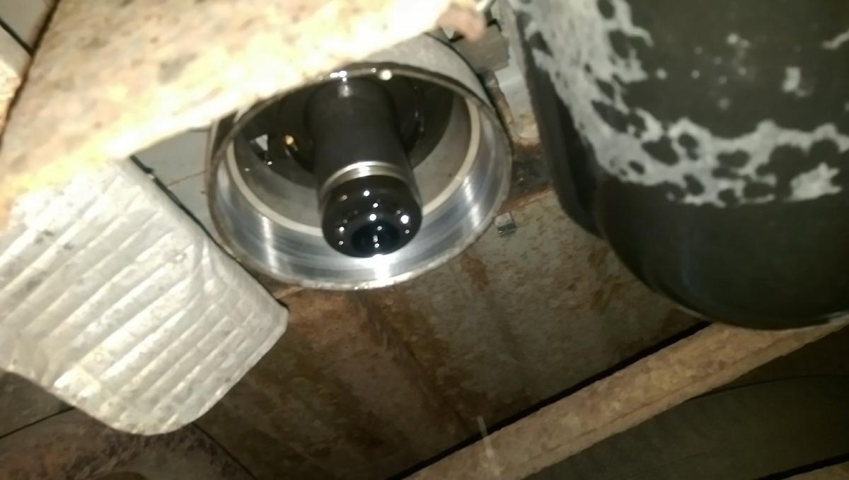

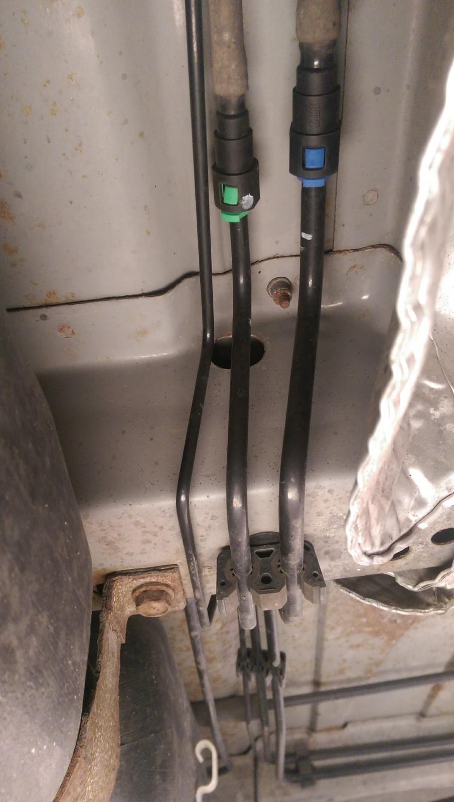

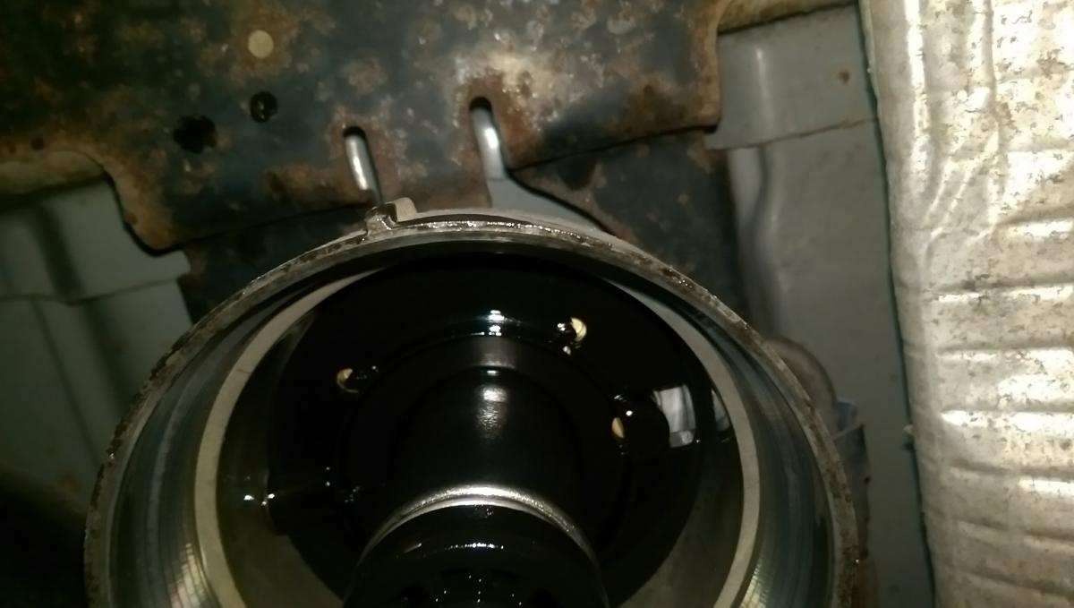

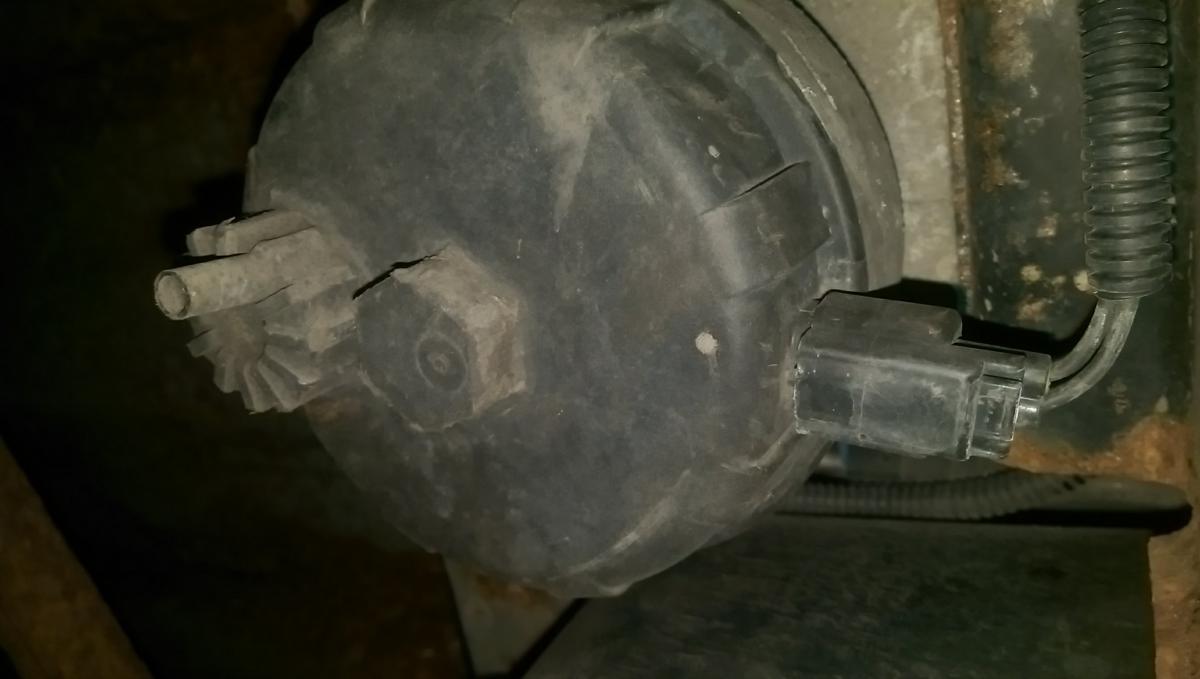

So today I've checked the fuel filter/lift pump. To clear up the confusion, mine is a 2.8CRD 2004/2005 which has an electric lift pump at the rear beside the tank, the filter is inside the plastic pump housing. I've attached photos to be clear! (There are so many variations)
Checked the plastic housing, O-ring, filter and what I could see of the fuel lines and all look good to me, no cracks in the filter housing, filter itself in decent condition, etc.

This is the filter and electric lift pump housing, which is on the driver side (RHD) of the fuel tank just in front of the rear axle:
Filter and plastic base housing has been unscrewed/removed:
Looking straight up into the pump housing:
Fuel lines running towards front of vehicle. Is it just me or do these look new-ish condition? I think they do and the tank looks relatively new too, so could these have been replaced before I purchased a couple of years ago perhaps?

Your fuel lines do look very pristine, maybe a previous owner was having this problem and they got replaces as part of the hunt for the fault?
