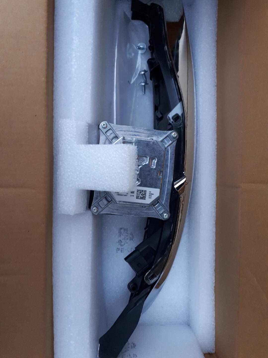

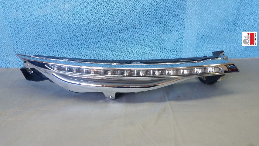

Hi all, I was driving my wife's Delta over the last few days and the left-hand front DRL has developed a fault.
It stops working after about 10 minutes, bringing on the orange alert light and the "ceck left-hand front sidelight" In true Italian style, when the car is switched off and back on, it works again for the 10 minutes!

Not seen any front failures yet, but both Neil and I have had rear led failure. They started to be intermittent but soon became permanent. I've not looked at a head light removed, but if they are anything like the rears, they are almost impossible to open without causing damage to the unit.
I did get mine open eventually to look at the circuit, and found a dry joint, but by that time I'd totally trashed the unit opening it up. I got a replacement from good old eBay Italia for about £130 from memory... the front may be more and also for the European market rather than UK rhd, unless they're switchable on the back??
Yes as Mike says Andrew - once they go I think you will find thats it unfortunately and a replacement unit will be required. That said I've not heard of another DRL unit issue before.....
Quick look on Italian ebay though show they are similar money as the rear units - circa 175Euro  :wacko:  If I see a cheapie I'll let you know!

I was onto a friend of mine from the old rallying days, based in the south of Italy
He says that it is supplied only by Marelli and although he doesnt have 1, he will have 1 in his shop tomorrow
Reckons €180 plus postage of €20.....fingers crossed now that it doesnt turn out to be Unicorn urine!!!

Ridiculous price really when you think about it! Should be about £80 really given the price of LED's and plastic!
Let us know how easy it is to fit? I'm guessing it's bumper off, whole light unit out to replace the DLR strip...
I have an electronic engineer friend, bursting to get his hands on the old unit, to arse about with it, to prove that it can be repaired :-D
