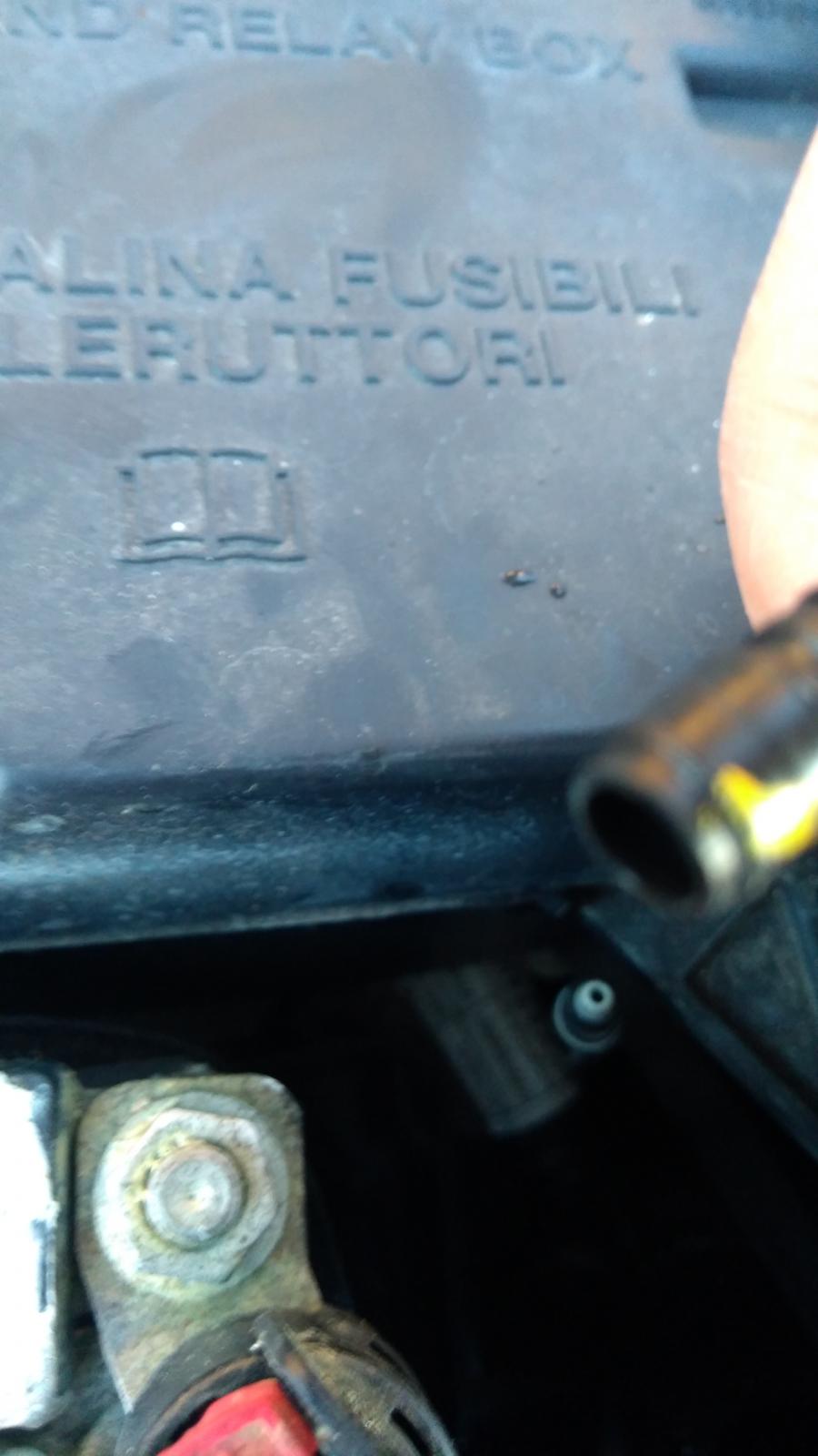

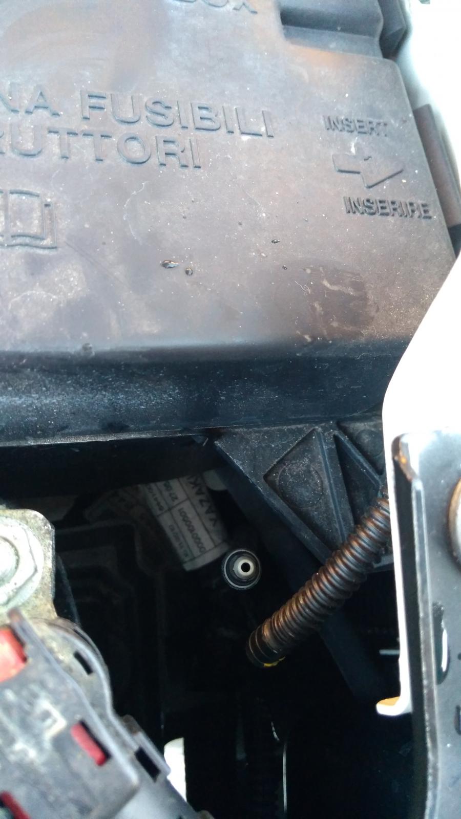

0 Dido Posted December 11, 2017 Author Report Share Posted December 11, 2017 Managed to trace the washing fluid tank backwards. With a bit of squirt the connection tubing was dislocated.Reconnected, superglue and a metal collar and back to business. MikeyRules 1 Quote Link to comment Share on other sites More sharing options...
0 MikeyRules Posted December 11, 2017 Report Share Posted December 11, 2017 Managed to trace the washing fluid tank backwards. With a bit of squirt the connection tubing was dislocated.Reconnected, superglue and a metal collar and back to business.It's always nice when it's an easy fix... So was it at the pump end where it had come off then? Quote Link to comment Share on other sites More sharing options...
0 Dido Posted December 12, 2017 Author Report Share Posted December 12, 2017 Looks like that. Have a look yourself... ?The collar I had was a bit too big, do you think duct tape can provide good seal... Quote Link to comment Share on other sites More sharing options...
0 MikeyRules Posted December 12, 2017 Report Share Posted December 12, 2017 Looks like that. Have a look yourself... ?The collar I had was a bit too big, do you think duct tape can provide good seal... Yeah looks familiar! I wouldn't use duct tape to be honest. You need some waterproof amalgamating tape that forms a seal like this: https://www.screwfix.com/p/self-amalgamating-rubber-tape-black-25mm-x-3m/2115V?tc=AT4&ds_rl=1249481&ds_rl=1245250&gclid=CjwKCAiAmb7RBRATEiwA7kS8VHHwSww2xiqOxWBkhf_Pmqs6cSJ0z2wBzGKAjEWPCZc7Cvp68OhhARoCyMUQAvD_BwE&gclsrc=aw.ds&dclid=CJDorvOXhNgCFRBuGwodAqQPbA Quote Link to comment Share on other sites More sharing options...
