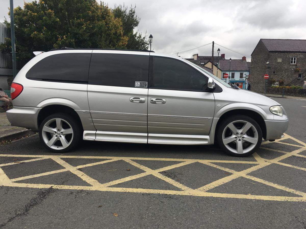

robbie2red Posted October 17, 2017 Report Share Posted October 17, 2017 Hi all, Do any of you know anything about the possibility of lowering these vehicles? Or has anyone done it? Any information would be much appreciated, thanks. Rob Quote Link to comment Share on other sites More sharing options...

0 robbie2red Posted October 18, 2017 Author Report Share Posted October 18, 2017 Thanks guys! Yes I love my GV (Entervan) now. It’s taken a bit to get it sorted but I’m happy with how it is now! And lots more I want to do! It would be nice if I could lower it as it would be so much easier to get up and down the ramp then! Take a look at the side on view guys, I reckon I can lower it a few inches, don’t you??? Quote Link to comment Share on other sites More sharing options...
0 bignev Posted October 18, 2017 Report Share Posted October 18, 2017 You know, it could probably be the wheel / tyre size doing it, but I'm sure it looks high at the back end compared to mine! Measured in the middle, ours is 20" from floor to top curve of the rear bumper.Or if you have the factory fit reverse sensor bar under the bumper, 13.75" to the underside. Quote Link to comment Share on other sites More sharing options...
0 robbie2red Posted October 19, 2017 Author Report Share Posted October 19, 2017 (edited) Cheers @@bignev, Yes just measured mine now, and it’s about 5-6” higher than yours. I know the wheels add a bit like but that does seem like quite a lot. I think my GV is the limited edition spec, would this have any bearing on it??? Edited October 19, 2017 by robbie2red Quote Link to comment Share on other sites More sharing options...
0 bignev Posted October 19, 2017 Report Share Posted October 19, 2017 That's a fair chunk higher! I've got the Ltd XS, but our previous Ltd, or the LX, weren't appreciably different. Unless the height is because of any mechanisms for the ramps maybe!? Quote Link to comment Share on other sites More sharing options...

0 Semmysonic Posted October 21, 2017 Report Share Posted October 21, 2017 Does look high on the back end. All I can think of is it's been stiffened up on the back to help stability with the extra weight of the equipment you have fitted. Anything is possible just depends on your budget. Quote Link to comment Share on other sites More sharing options...

0 robbie2red Posted October 21, 2017 Author Report Share Posted October 21, 2017 Thanks guys. Semmy that’s exactly what I did last night, typed in dodge minivan/caravan when searching and found a bit more info. My mechanic doesn’t really know anyone that works with leaf suspensions. But from what I found out on the forums last night they can be de-arched?! Front suspension isn’t a problem obviously. But I’m going to contact a leaf spring specialist to see if they would de-arch the leaf springs, and go from there. What do you reckon? Quote Link to comment Share on other sites More sharing options...
0 robbie2red Posted October 24, 2017 Author Report Share Posted October 24, 2017 Hi again! I’ve been in touch with the leaf spring specialists and it’s no problem at all to de-arch the leaf springs for them. So...all I need to do is find some lowering springs now! Any ideas where I can find guys??? About to search the web! Lol. Quote Link to comment Share on other sites More sharing options...

0 dan1chrysler Posted January 4, 2018 Report Share Posted January 4, 2018 (edited) Hi Rob, I'm following this topic now. I also want to do the same with my Entervan, I am thinking that the way forward is to lose the leaf springs all together! You would need to get a 4-link suspension kit made up like a rock crawler would use, but on a lowered scale. The reason for this suggestion is because the rear corners of the modified floor of our entervans actually fouls on the leaf springs, this seems to be the case with mine.so removing the curve on a leaf spring would be really bad. An average GV has an anti roll bar/stabiliser behind the rear axle, but Entervan "braunability" decided to throw it away. the one sided lowering system would probably fail the the bar was left in place. The front of the leaf is mounted lower to meet the modified floor, That's is why the rear end is up in the air. Custom made linkage would be the way to go. Example below shows coils, but imagine airbags. The axle in the pic has a differential in the middle of it, it's for a RWD pickup truck. But there is no reason why this can not be achieved with the straight box section dead axle under the rear of a Voyager. http://i206.photobucket.com/albums/bb93/ELpolacko/1951%20Chevy%20Truck%20Metro%20Auto%20Auction/IMAG0729.jpg Get an air ride system from a lowered VW Transporter specialist. I had a look on Instgram for Air Systems #loweredlifestyle #bagriders #airride #slammedvans #AirSociety #unreal_automotive #airtisan I looked up the last one, they are in Coventry... https://www.airtisan.co.uk/services-air-suspension Edited January 4, 2018 by dan1chrysler Quote Link to comment Share on other sites More sharing options...
