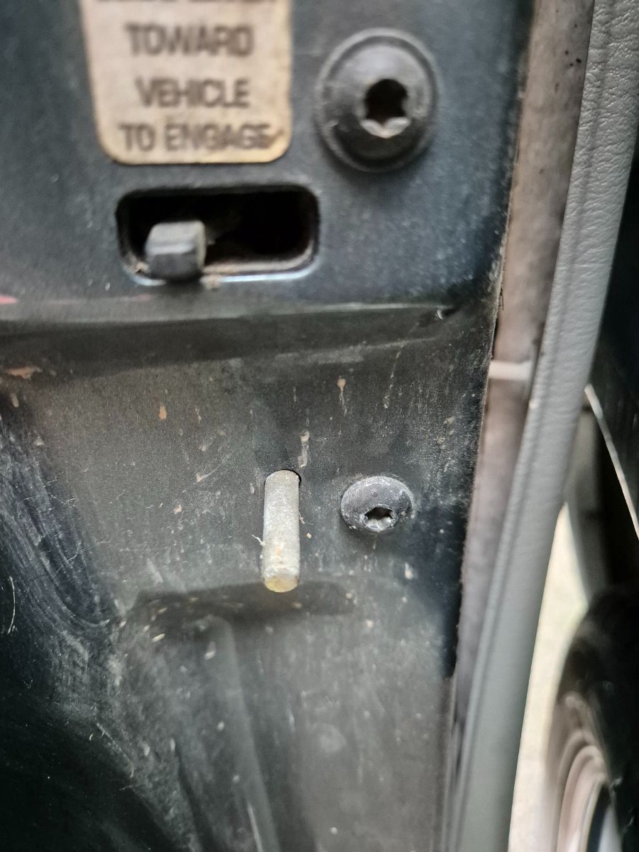

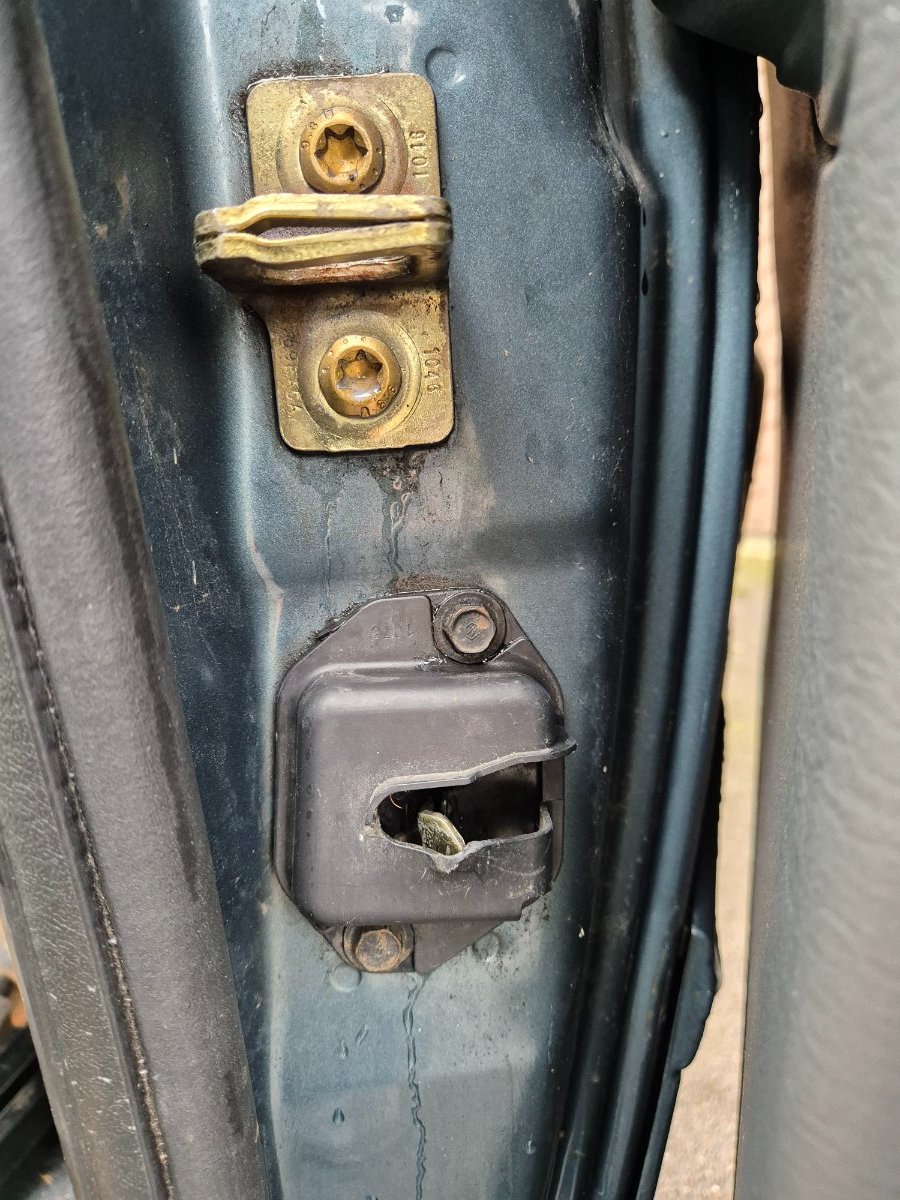

cerbie Posted November 18, 2024 Report Share Posted November 18, 2024 (edited) Hi, I have a 2006 Grand Voyager 3.3 Could anyone identify the part (picture attached) that protrudes from the near side inner door frame, slides up and down and engages with a pin that protrudes from the rear of the door assembly when closed. This is only on the passenger side of a RHD UK car. I am having the following issues that could all be related and would like to eliminate this lever. Both rear doors do not operated electronically Single beep from the alarm when arming Any ideas and thoughts very welcome. Thank you. Edited November 18, 2024 by cerbie add pictures Quote Link to comment Share on other sites More sharing options...
bignev Posted November 21, 2024 Report Share Posted November 21, 2024 Hi there! Don't know why the rear doors are playing up, but try removing the IOD fuse for 20 minutes, quite often resets some things. That protrusion on the door, is linked to the petrol flap, to stop the door opening if the flap is open being filled. Quote Link to comment Share on other sites More sharing options...
