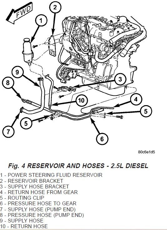

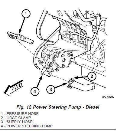

On 2.5crd 2006 voyager
My high pressure power steering pipe is spurting fluid out and it needs replacing.
Is there any videos on here showing the removal of the pipe because it looks like a major operation as one end goes up the back of the engine and in a awkward place to get to .
Please help .
I don't think I could even make it to mechanics 30 miles away.
