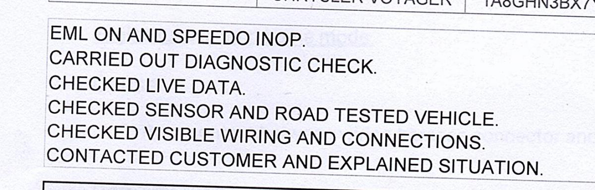

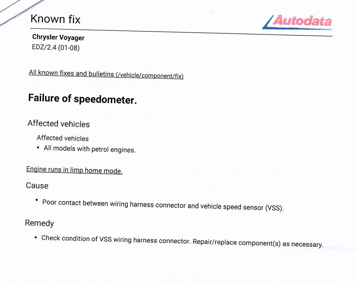

0 Foggieloon Posted October 3, 2017 Author Report Share Posted October 3, 2017 Hi Mike,Thanks for the fast response.The vehicle is a 2.4 manual petrol.I have attached the garage report and it seems they they have checked the sensor?they also supplied me with known fixes for this problem also attached Quote Link to comment Share on other sites More sharing options...
0 mikebh8 Posted October 4, 2017 Report Share Posted October 4, 2017 Mine was looking same as the one that I replaced with, did they remove the sensor or just tested..?A manual car will not go into limp mode because of the speed sensor, an auto probably.Mine was identical with the replacement one, the difference (not visible by eye) is the plastic gear was worn and not engaging with the shaft...I don't remember where I put the old one but if I find it I'll upload a picture so you can see there is no difference.Is wither that or the gears o the shaft...is very unlikely but if you have access to a second driveshaft try replacing it... Quote Link to comment Share on other sites More sharing options...
0 Foggieloon Posted October 4, 2017 Author Report Share Posted October 4, 2017 Hi Mike,The vehicle does not go into limp mode.You may be right about the sensor. It may be worth purchasing a new sensor.Is it a pig of a job?I have a workshop manual on cdand a haynes manual.cheers Stifler 1 Quote Link to comment Share on other sites More sharing options...
0 mikebh8 Posted October 4, 2017 Report Share Posted October 4, 2017 Is not difficult, a bit of oil will come out, it can always be refilled. I got one from scrap yard, if I remember well was £8 or £10... It is held by one bolt( again if I remember well) 10mm size.When you fit the "new" one, play it a little bit or move the shaft slightly left and right so it settles in properly.. Hope you sort it. Quote Link to comment Share on other sites More sharing options...
0 mikebh8 Posted October 4, 2017 Report Share Posted October 4, 2017 Hi Mike,Thanks for the fast response.The vehicle is a 2.4 manual petrol.I have attached the garage report and it seems they they have checked the sensor?they also supplied me with known fixes for this problem also attachedOn the first picture it says road test, did that involve a diagnostic machine hooked to the ECU and the speed came up?!?!I doubt. Quote Link to comment Share on other sites More sharing options...
