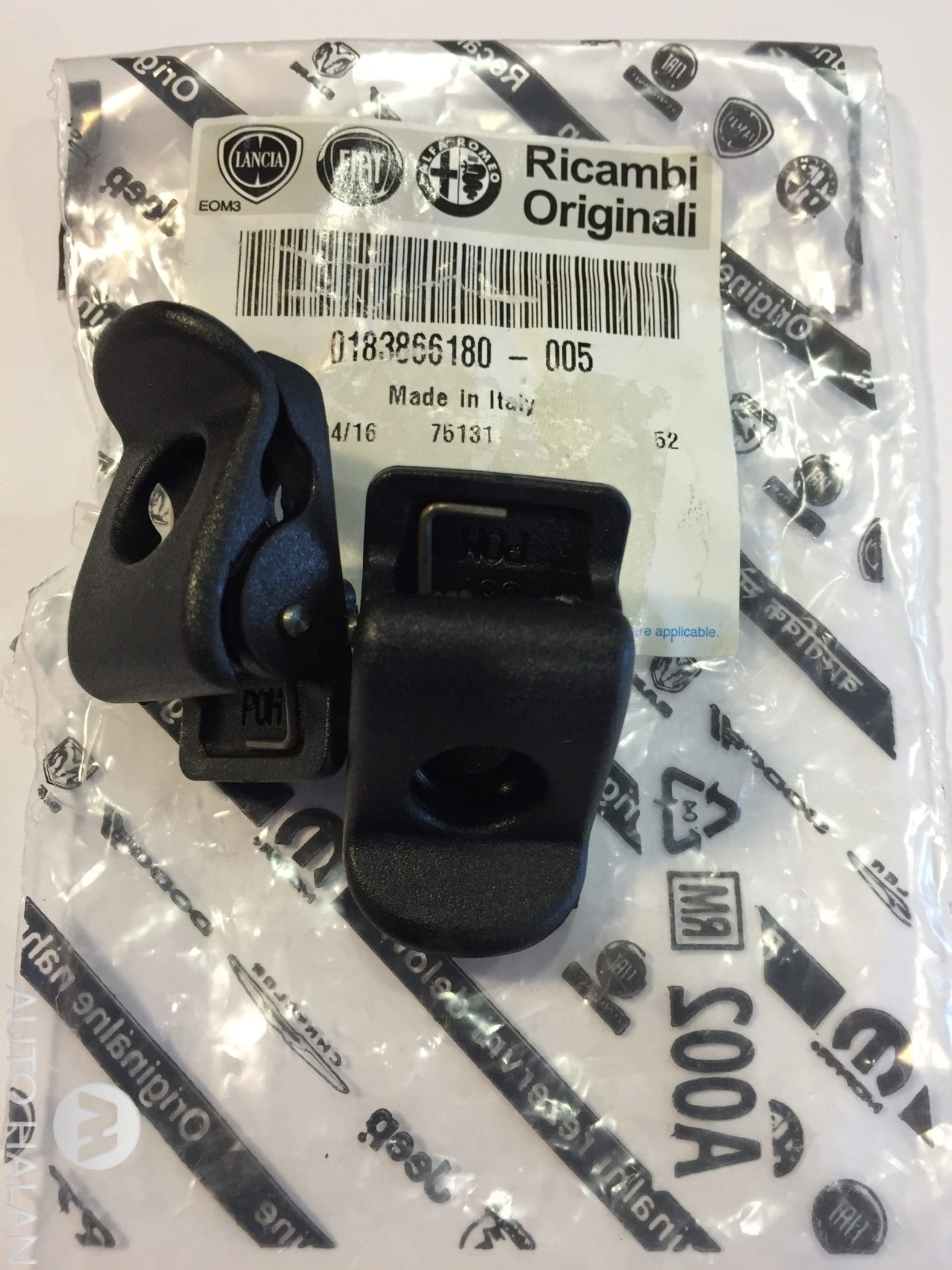

Just became the proud owner of a Limited recently and I went to lower the back seats and snapped one of the clips that hold the retractable load cover f@!*
Anyone know where to get replacements - are they used on the Bravo?

This is a nightmare component.
You can buy them direct from FIAT in bags of 500!
Alternatively, my dealer managed to get a couple by ringing around.
Suggest that you try FIAT Chysler help line....
If you find a dealer (via the www.google) in Belgium / Italy, a couple of phone calls may resolve your problem.
Remember that its a Lancia Delta when you talk abroad!
They are not used on the Bravo / Brava.
Sorry I don't have the part number - or a spare!
If you find a supplier - please post them on here.
Penguin
Yes that's the Part Number and according to eper you can order them with a minimum amount of x5 -
183866180 HOOK http://eper.fiatklubpolska.pl/2009/img/common/carrello_proposta2.png Famiglia: MX01 - VARIOUS-SEATS AND UPHOLSTERY Availability: Product that can be ordered Minimum quantity per package: 5 Macro-family: V Discount code: V Weight (grams): 10 Listed price(1): 10,40 EUR Measurement unit: Num Price including taxes: 12,69 EUR
You should be able to walk in to any Fiat dealer and request now you have a Part number. It is a Delta specific part though.
A Chrysler dealer will have a different Part number but any decent Fiat dealer should be able to assist (we're all FCA now ;) )
