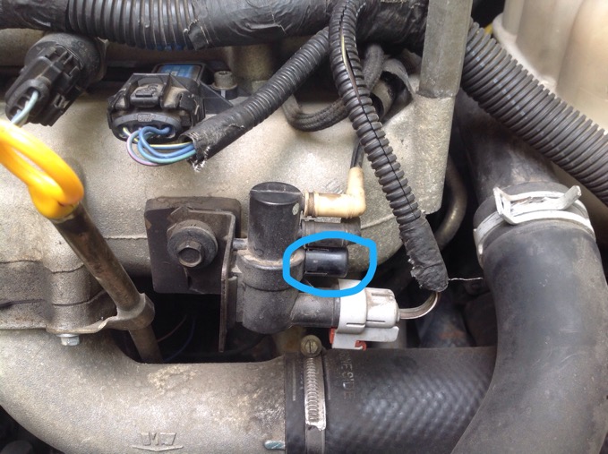

I recently noticed this when i'd turned off the engine there was a hissing noise coming from here (see image), is it usual ?post-1968-0-23437500-1503665227_thumb.jpg

that component is the EGR solenoid. But I couldn't say if that hissing noise was okay - but I've never heard a noise like the one you have ( not saying whether that's right or wrong)
