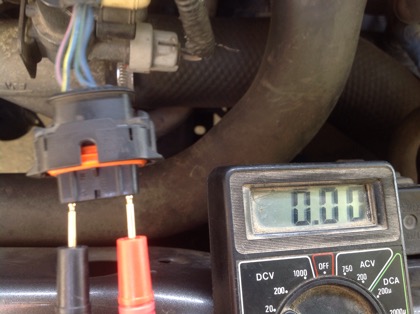

Hi I've received the new probes for my multimeter so i'm going to be able to carry out this test.
I presume you mean the pins on the plug whilst it is disconnected from the sensor ?
Pin 1 is the earth right ?
cheers.

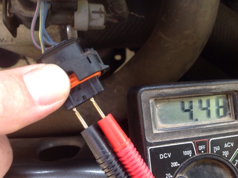

Looking at the second reading you have - 4.48v between pin 1 & 3 suggests an open circuit ( bad connection, corroded pin, chafed wire, broken wire) But that's just utilising the Chrysler diagnostic manual.
Out of curiosity, have you had the boost pressure sensor out and checked if its gummed up ?
Edited by ryden
I've checked the sensor and it's ok.
Checking for damaged wires would mean opening the loom and following them to ?? Do they go to the ecu ?
I'm tempted to disconnect the Ecu and give it a go with contact cleaner,whats the procedure ? batterie earth plug off first and then disconnect the plug.
Hi, I was rechecking the fault code you posted... my apologies for not looking properly
It turns out to be twice one after another in the same list of faults.
So, first is ( same fault code as I already said) P0235 MANIFOLD ABSOLUTE PRESSURE (MAP) SENSOR A, TC SYSTEM- (cause) CIRCUIT MALFUNCTION (I can only assume it can be related to the wiring of the other one)
The second time is: TURBOCHARGER (TC) BOOST PRESSURE SENSOR A/ SUPERCHARGER (SC) BOOST PRESSURE SENSOR A- CIRCUIT MALFUNCTION - WIRING TC/SC BOOST PRESSURE SENSOR
Inspection is to be made with the plug in and as stated before, two tests, one at idling and one at 2500rpm and my guess is that boost sensor is sensor A in the circuit.
