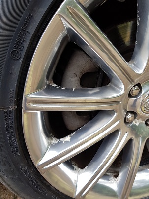

Hiya everybody,
Been checking out the forum a few times now just for interest but now I need some guidance from hopefully some fellow SRT owners
I have a 60 plate SRT saloon and it's chrome wheels aren't the best (shame cos the rest is bar a few minor scratches) and I would like to know best way (or any way) to get the wheels re-done?
Thanks in advance,
Scotty
