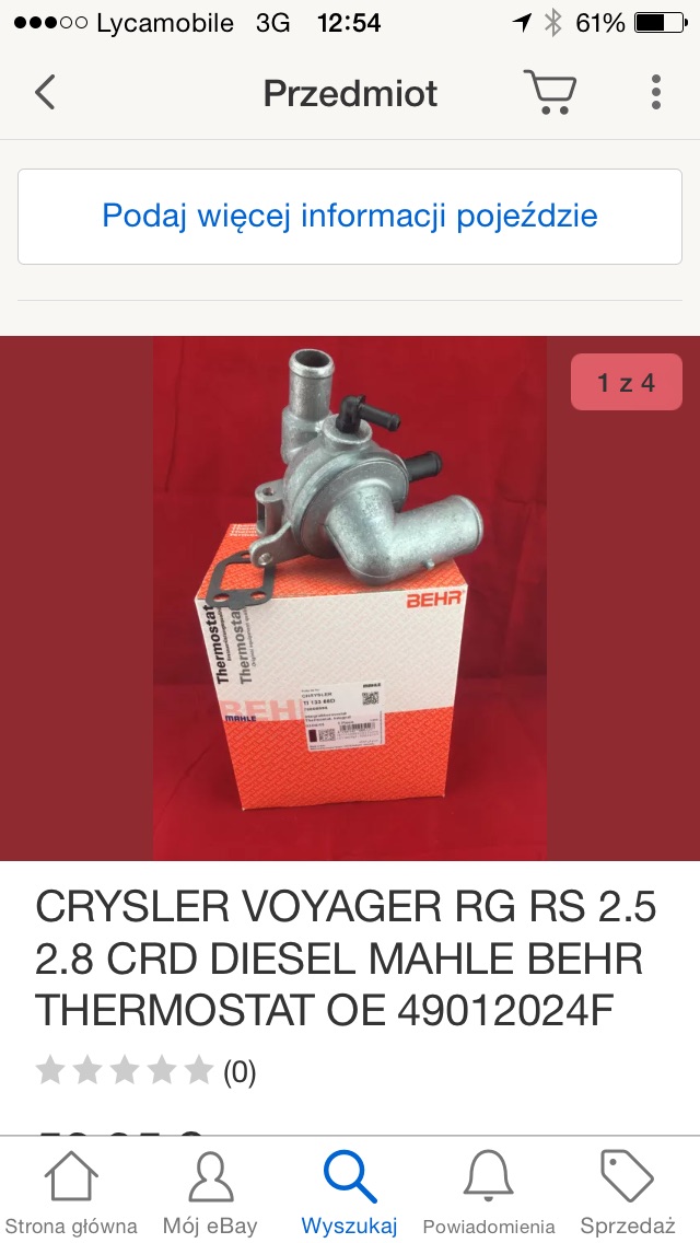

This thermo looks ok for that car.
Same as mine.

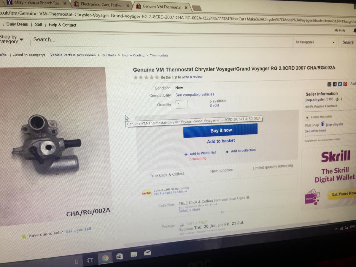

That is the thermostat he has got. (Your picture ). But he said the cable and sensor from the temp gauge in car does not mount on that one. The one I have posted has a hole threaded for the sensor. The shine you part on my picture
The hole is for a 90 degrees connector that is hooked to a hose which goes into the expansion tank...still no wires to it.
