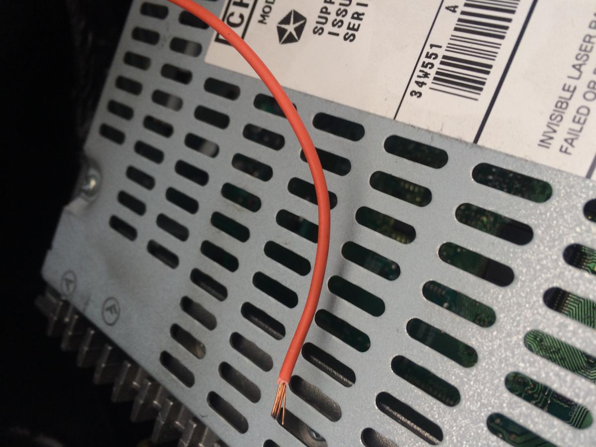

0 karmannski Posted July 18, 2017 Author Report Share Posted July 18, 2017 Ok need Help With one is the IGN wire ? Quote Link to comment Share on other sites More sharing options...

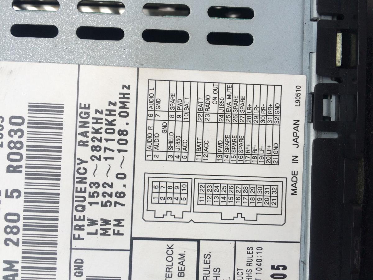

0 karmannski Posted July 18, 2017 Author Report Share Posted July 18, 2017 Ok need Help With one is the IGN wire ?I'm idiot, thinking to much It says 22!!!! It is working now, but no sound All plugs in. Setup ? Quote Link to comment Share on other sites More sharing options...

0 bignev Posted July 18, 2017 Report Share Posted July 18, 2017 Yep I'd guess 11 and 22 are the permanent live and ignition on live - anyones guess which is which though. I spotted in another post you look like you got it sorted, switch "on" the screen with the remote control, yes it's daft isn't it! Not the same on all models either as you've seen! Quote Link to comment Share on other sites More sharing options...
0 mikebh8 Posted July 19, 2017 Report Share Posted July 19, 2017 The pins 11 and 22 are ground, plus/positive are the ones marked "fuse...(something)" as none of the wires would go straight do the battery "+" is fused and "batt" is negative/minus. http://www.tehnomagazin.com/Auto-radio-car-connector/CHRYSLER-Car-Radio-Wiring-Connector.htm Hope it helps. Quote Link to comment Share on other sites More sharing options...

0 bignev Posted July 19, 2017 Report Share Posted July 19, 2017 Good you got it sorted, but that reference diagram in the picture is a bit rubbish isn't it? 2, 7 21, and 32 connections say "GND" now I would definitely have gone for ground or earth or negative on that terminal! Quote Link to comment Share on other sites More sharing options...
