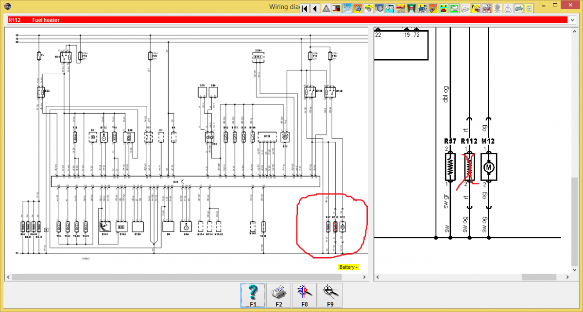

0 mikebh8 Posted February 28, 2018 Report Share Posted February 28, 2018 Im following this as I have the same short.If your electrician finds it it would be useful to know the colour of the wire and the location. The one in the middle is the fuel heater...if it helps.It joins the "crankcase breather heater" and both go to fuel heater relay.See picture attached. frogland 1 Quote Link to comment Share on other sites More sharing options...
0 blackvelvet Posted March 1, 2018 Report Share Posted March 1, 2018 What I find strange FROGthe fuse also serves the fuel pump.So how can the fuse be disconnected? unless someone has found the path of the cable and diverted the power to the pump from somewhere else..If so it could lead to major problems finding out exactly where. Quote Link to comment Share on other sites More sharing options...

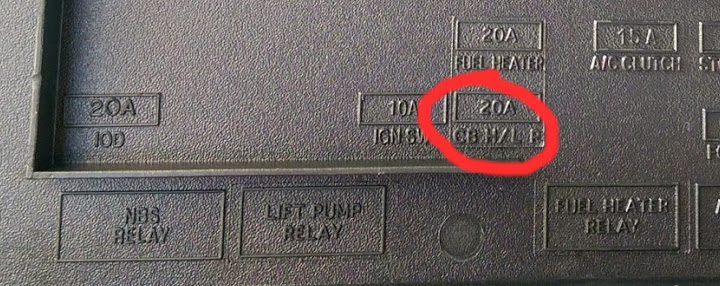

0 andyb2000 Posted March 7, 2018 Report Share Posted March 7, 2018 Hi @@blackvelvetThe fuse doesn't supply the fuel pump also, just the heater, hence how it was totally removed (as was the relay) on mine but electric lift pump still worked. See the diagram on my fusebox which illustrates this: The highlighted is the lift pump fuse, above it is the fuel heater fuse. Quote Link to comment Share on other sites More sharing options...
0 blackvelvet Posted March 7, 2018 Report Share Posted March 7, 2018 Thanks for both replies Andy. I thought the diagram told me that the fuse for fuel heater is also fuel pump.I will check again tomorrow.My car has been starting fairly well since I returned from Bolton. Of course the weather is warmer, so I don't believe Bolton is to blame.However, when the engine is running,I notice the RPM doesn't change at all when I shift to drive from park. and vice versa.Do you know where the pump is located? is it in the tank?My manual says it is in front of the rear axle. 2006 2.8Thanks Mate Quote Link to comment Share on other sites More sharing options...
0 andyb2000 Posted March 8, 2018 Report Share Posted March 8, 2018 (edited) No problem, yeah look on the fusebox that should confirm it. I think the 2006 is the same as mine, so yes fuel lift pump (heater, filter) is beside the fuel tank approx in the middle.(Remember this is the low pressure primer/lift pump not the main high pressure pump that is driven from the timing belt) Take a look at my video that covered all of the cold problems I had https://www.patreon.com/posts/chrysler-grand-2-17356742I cover the fuel filter, fuel heater and it's housing on the video and also show where it's located/mounted so should help you identify.Approx 11min50 is where I cover the fuel filter and pump. Oh, also video where I change the filter: Edited March 8, 2018 by andyb2000 Quote Link to comment Share on other sites More sharing options...
