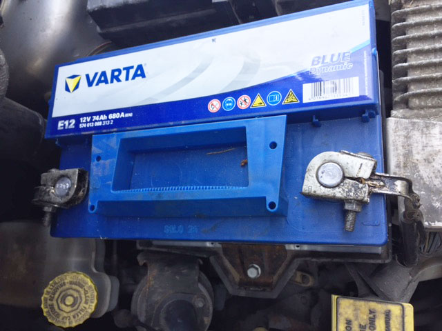

The battery is a Varta E12 74Ah 680A. It's brand spanking new but was dead overnight after fitting due to the drain. I guess it IS only partially charged then since I'm only reading 11.2v from it with a multimeter. I'm using a Halfords battery conditioner to try and save it.
Is this the best battery to be using?
thanks

The battery you have may be a little on the small side, however having said it shouldn't have drained it that quick!
I have heard of batteries being drained if the key isn't turned to the correct position (don't know how true that is though)
Which battery would you suggest? It's tricky as the size needs to be exact and the terminals I gather are the other way round from normal.

The blue stuff in #4 cover most you need to know. The battery you already have should be adequate for these temps, personally I like 800/80 for British winters. Most 800/80's will not fit the battery tray and a saw/angle grinder needs to cut bits off. The Optima 'red top 4.2' spirals are one battery that will go straight in - straight swap and do the job. Most 'conditioners' are useless IMO, always take pro advice. Conditioners describe de-sulphing, a one year old battery no matter how badly treated should need de-sulphing. You can pay a fortune for smart chargers, I bought a 7 stage 'grey' smart for about £20 and I know it works so you can get one cheap. Start by giving your existing battery a good charge, if you can't get it to 12.75 its goosed, I've got a pro digital CCA counter you would be amazed to see how many infrequently used cars don't put out even 1/2 their stated CC starting amps. Want more - ask, we are all here to help each other. Best of luck.
Optima thread here, type 96 describes all / any brand close to 80/800 such as the Varta E38 etc. Dont ever under any circumstances use one of those put your REG in here. Loads of info including cutting the battery tray walkthrough here. If the O/P has had issues since 2003 what recent changes to wiring particularly new radio have been made to wiring leading to IOD issues and parasitic drain. Does the O/P live anywhere near the north of the north of England ?

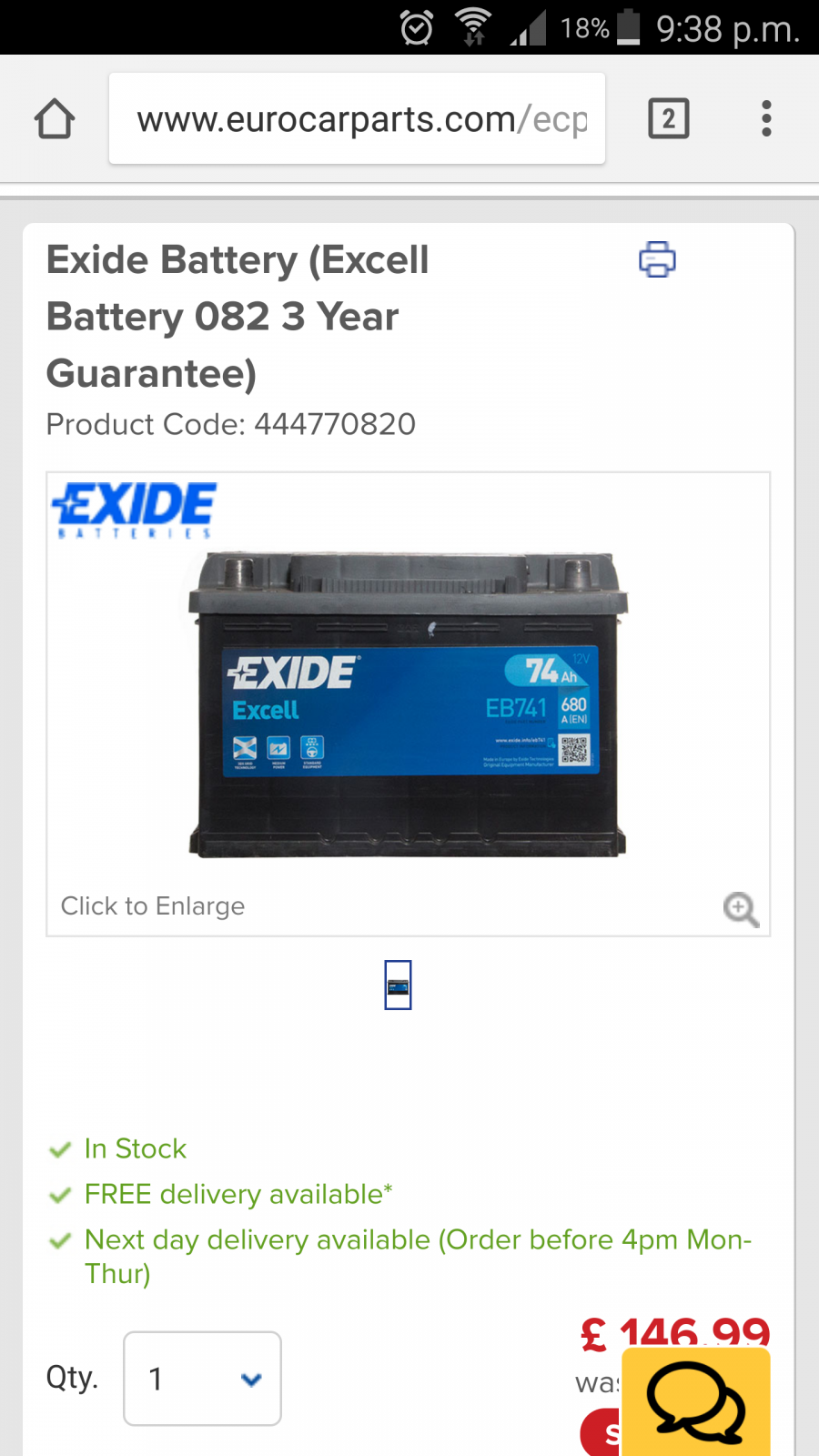

The perfect fitting maximum is 77Ah.
For example from Exide (good, and not expensive from internet), if you grind the tighten bottom bulges at the short sides of battery some milimeters at both sides.
Grind away until the hollow bead is open at front. You need only the bottom bulges at long sides for tighten.
And use an ampermeter (as clamp from £9.21 up on ebay) to chek, if power is consumed after switch off the car.
