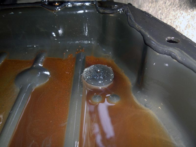

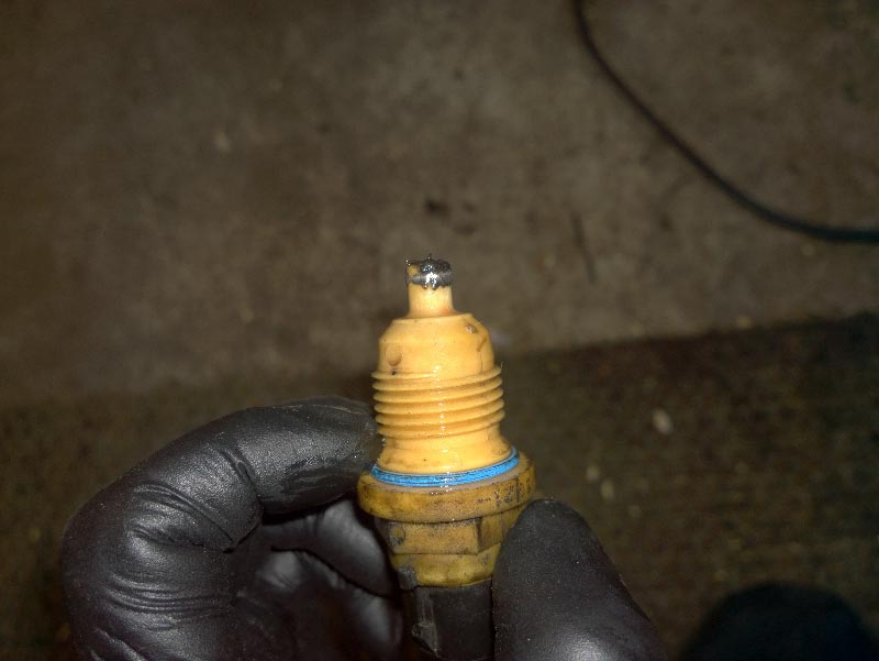

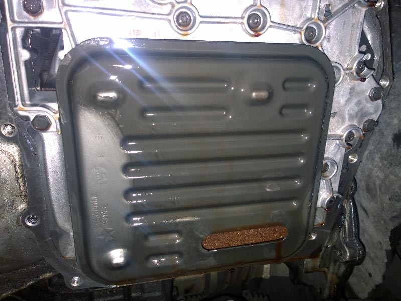

0 SebringLA Posted April 5, 2017 Author Report Share Posted April 5, 2017 Changed speed sensors, filter as you can see its original chrysler, fluid was brown.Magnet had some metal that was soft to touch and very few tiny pieces of metal size of sand that i feel.Also output speed sensor had same stuff as magnet on it because it has magnet inside.Check engine was gone but now after driving on 55mph and some city for about 30 miles i got check engine code back however car does drive fine at this point. P0740 - Torque Converter Clutch CircuitP0700 - Powertrain Transmission Control System (Mil Request) Quote Link to comment Share on other sites More sharing options...
