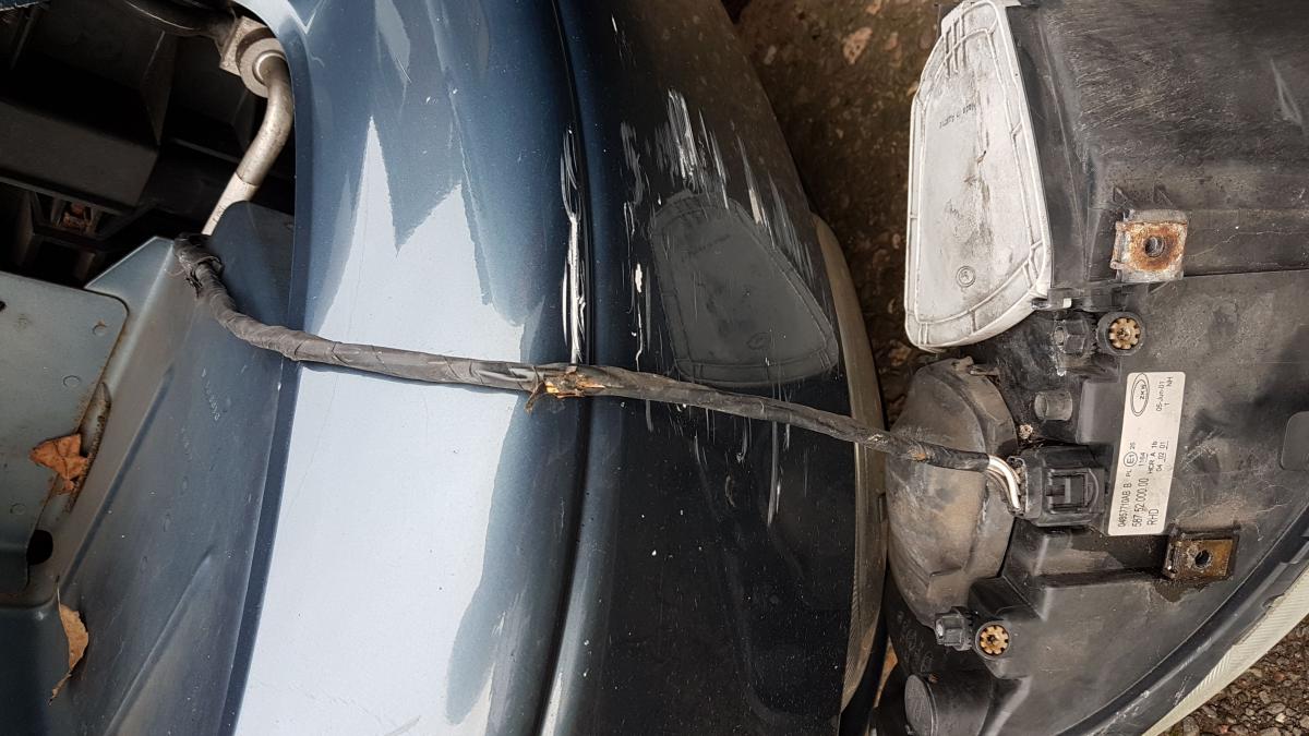

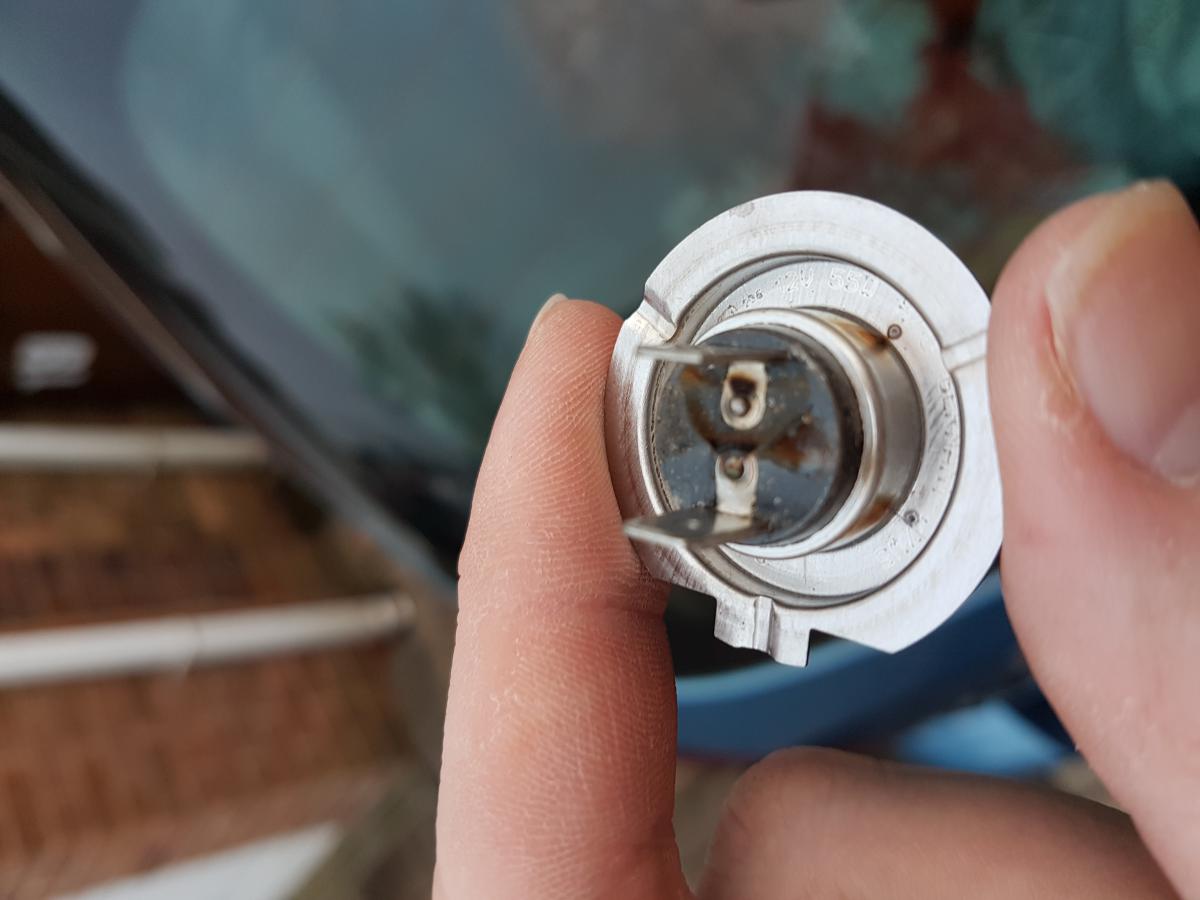

0 ametcalfe1989 Posted March 7, 2017 Author Report Share Posted March 7, 2017 So it turned out to be a bit of the insulation had come away from the driver side loom and the wiring had corroded.Which had in turn, blown both bulbs so I cut back the dodgy wire to before the corrosion, rewired it and changed the bulbs. Now we have light!!!! Quote Link to comment Share on other sites More sharing options...
