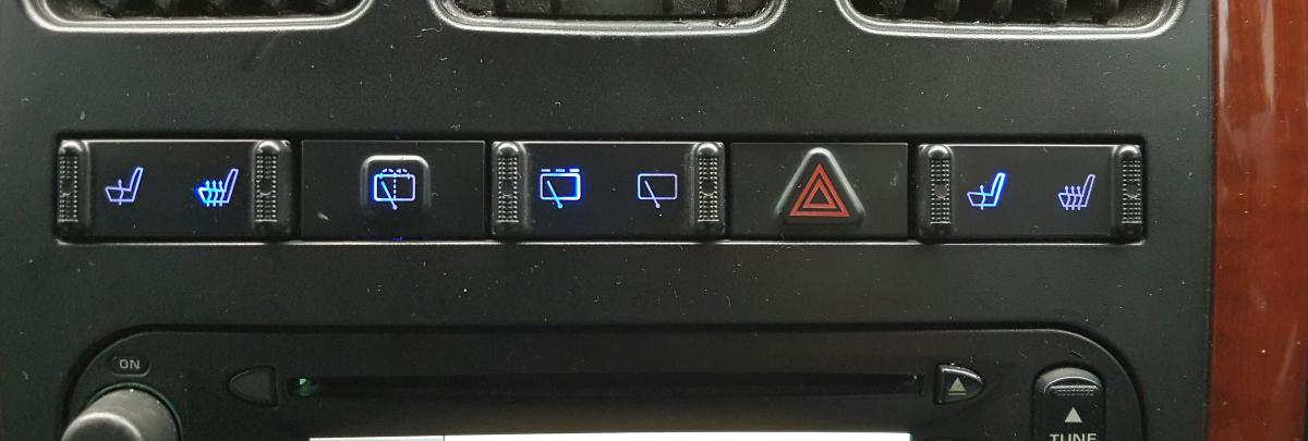

0 Stevec0268 Posted January 30, 2017 Report Share Posted January 30, 2017 Hi, I recently had the same problem with the heated seats/rear wiper switches. Following andyb's instructions I fitted some LED's I had acquired years ago for a different car and had never used. I have got them all fitted and they are a nice bright blue! When I get chance later I will upload a pic. Sorry didn't get back to you Andy to say I had got it done, but this is the first chance I have had to get back on the forum. Many thanks for your help. andyb2000 1 Quote Link to comment Share on other sites More sharing options...
0 Stevec0268 Posted January 30, 2017 Report Share Posted January 30, 2017 Here's the pic. Quote Link to comment Share on other sites More sharing options...
0 andyb2000 Posted January 30, 2017 Report Share Posted January 30, 2017 They look spot on Steve, glad they've done the job.I've ordered those little strip/model LEDs so going to take mine apart and test those out as an alternative, probably post a video online with it for anybody in the future interested. Quote Link to comment Share on other sites More sharing options...
