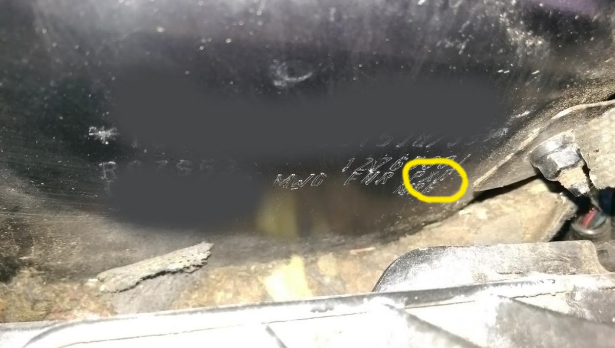

But, on mine (2005 2.8CRD UK) the paint colour code was under the bonnet, to the left on the suspension support (beside the airbox) stamped into the metal, so was quite difficult to read, but experiment with different light sources and the camera on your phone and you'll get the colour code to match up.
(I used a chipex colour repair kit previously and that got a perfect match using those colour codes)
The paint code should start with a P so for mine it's PXR (Which is the Brilliant Black Crystal) which is also know as AXR.
Mine is attached, if you look at the highlighted part that shows my code of "PXR" and you can also check it on this site http://paintref.com/cgi-bin/colorcodedisplay.cgi?code=PXR&manuf=Chrysler&rows=50
Hope that helps you check and find the right one!
