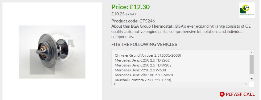

I'm certain that I need to replace the thermostat on my 2003 2.5 CRD Grand Voyager,
My workshop manual states that I need to replace the sealed unit (so that's what I'm expecting to do..)  I went to Andrew Page motor factors and they pulled up 2 options for a replacement.  One was a sealed unit thermostat for around £100 but the other was a 'naked' thermostat for about £12!!
Have they made a mistake, or is there an option for me to save £88?
As ever, all advice gratefully received :-)

I found out that the thermostat I bought was actually mis-labelled in the database and was for an earlier voyager variant.
I didn't fancy waiting for 2 weeks for delivery of the ebay thermostat that andy mentioned in his youtube notes so I did a little research on similar types.
I picked up a thermostat for a 1992 Renault Clio 1.1 Engine code C1E700. It was about £8.  It didn't have the same housing as the one Andy used, but the disc type.  I had do do a fair bit of filing to reduce the diameter.
It works a treat!
