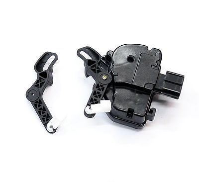

Firstly I'd take the door panel off and look at the servo itself. Use the central locking and whilst it's triggering the other doors try to 'help' this one with your finger, see if you can feel the motor trying at all. If it's trying even a tiny amount then it's just the servo has failed and needs replacing.
If it doesn't do a thing and you have a multimeter, put that on DC voltage, 20v and put the probes on the two pins that feed the servo, again try the locks and see if the meter shows a jump in voltage then back to 0. If it jumps then you know you're OK on wiring, etc, and it must be the servo.
If you don't get any voltage to it then the original point about wiring being faulty sounds a good bet, and my money would be on the wiring "chain" that you can see when you open the door coiling along the bottom, take that apart and check for damaged cables, they are normally reasonably obvious if they're broken.
