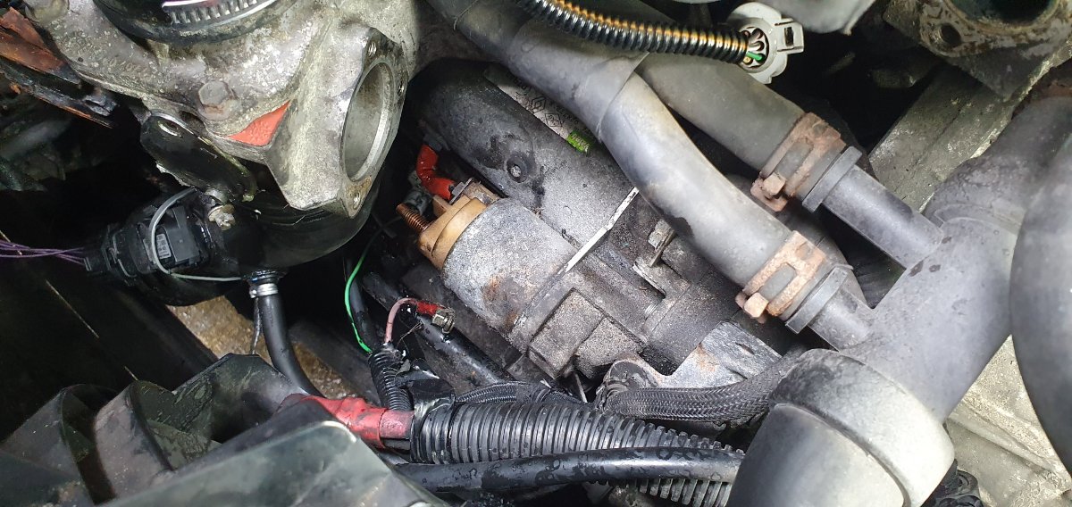

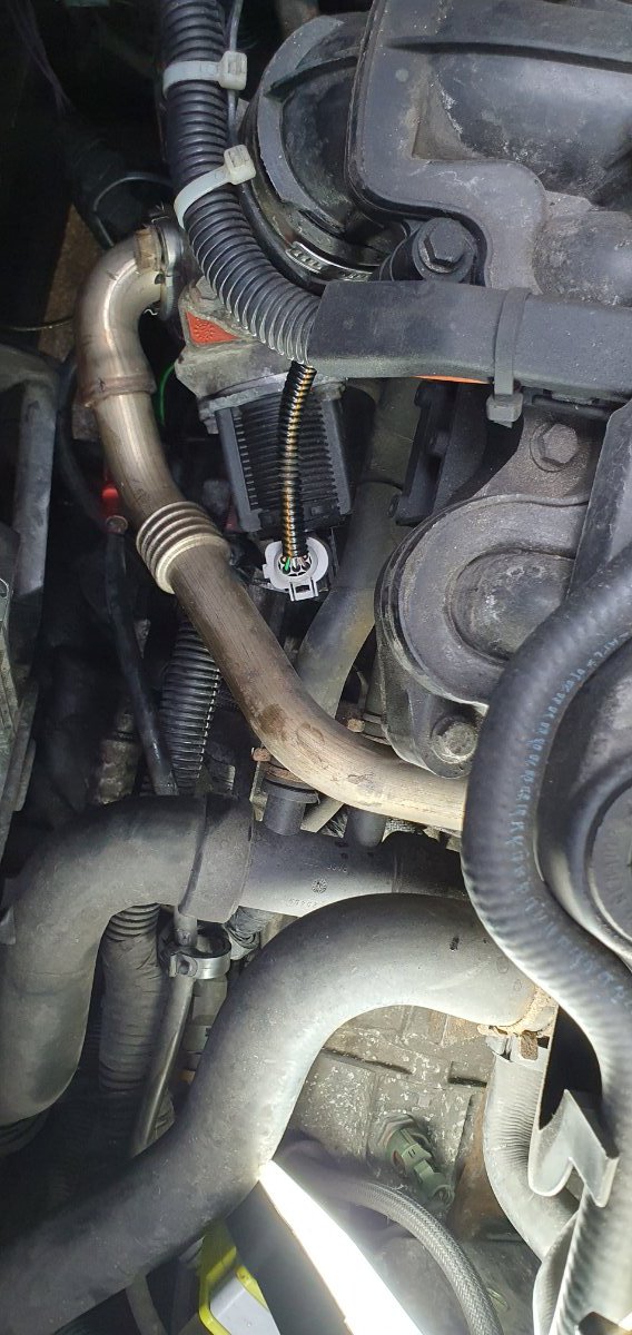

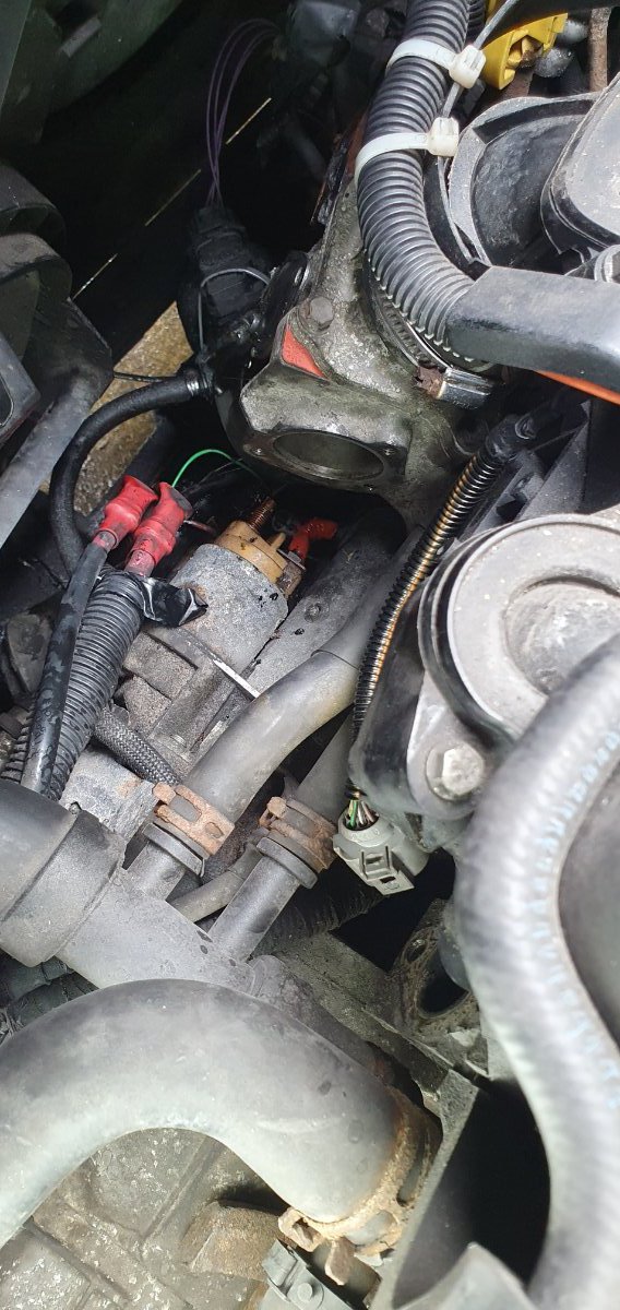

Disconnect the two vacuum pipes connecting the ERG valve to the solenoids.
You should be able to access the jubilee clip securing the EGR's air inlet pipe, slacken off and push the pipe downwards.
There is a circular clip holding the EGR valve to the sump feed pipe (where all the sh*t comes from), then insert a #5 allen key and unscrew fully. CAREFULLY bend the clip open until it can be dropped down the pipe.
Remove the 4 8mm bolts securing the valve to the inlet manifold pipe.
At this stage I would suggest you do not do this over a grass driveway as I did because finding the dropped bolts is a nightmare.
Lift the EGR valve out. (Be patient, curse freely - it will come out.

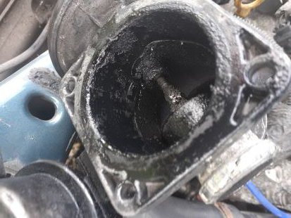

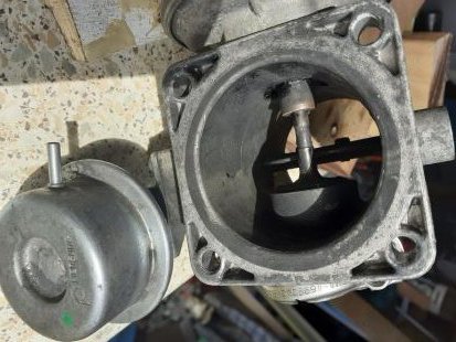

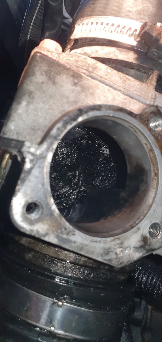

If you are removing, cleaning and refitting have fun. I still have remnants of the gunge in my fingernails despite gloves, swarfega and petrol.
[Note the EGR cleaning spray I ordered hadn't turned up so I used some industrial cleaner (modern type [non smelly] Gunk - for those of you that remember solvent based degreasers)
After cleaning or unwrapping your replacement valve I would suggest holding the valve in place by loosely fitting 2 of the 8mm bolts to secure the valve against the inlet pipe before refitting the pipe clamp underneath the valve. - PATIENCE patience patience.
Then fit the other two bolts and tighten all four.
Refit the vacuum pipes, refit the air inlet pipe and tighten jubilee clip, refit coolant tank, top up any lost coolant, refit battery. Should be done!
