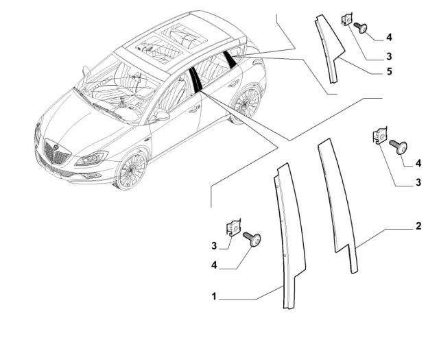

0 Lucky Posted June 16, 2014 Report Share Posted June 16, 2014 Hi, I've noticed a tiny bit of rust on these panels on my 2010 Executive Twinturbo. How do I remove them? The trim under the windows is lifted straight up, but what about the top and side trimming? I don't like the try&fail method when it comes to plastic trim on my Delta.. I'm from Norway, and there hasn't been an official Lancia dealer here since late 90's, and the Chrysler dealers couldn't care less, so it's not so easy to get these parts if they break. Quote Link to comment Share on other sites More sharing options...
0 Nello Posted June 17, 2014 Report Share Posted June 17, 2014 (edited) Hope this helps Lucky - If you can get to them looks like they unbolt/off bolt/on.......... Showing around 68Euro on eper.... Edited July 8, 2014 by ben Attached Image ben 1 Quote Link to comment Share on other sites More sharing options...
0 Lucky Posted June 17, 2014 Report Share Posted June 17, 2014 Thank you! I will check it out. Haven't noticed those bolts, but I will have a look and see what I can find. Quote Link to comment Share on other sites More sharing options...
0 T14086 Posted June 22, 2014 Report Share Posted June 22, 2014 If you decide to buy them you will see where the bolt(s) are, often Chrysler hide them behind the inner glass seal. Quote Link to comment Share on other sites More sharing options...
