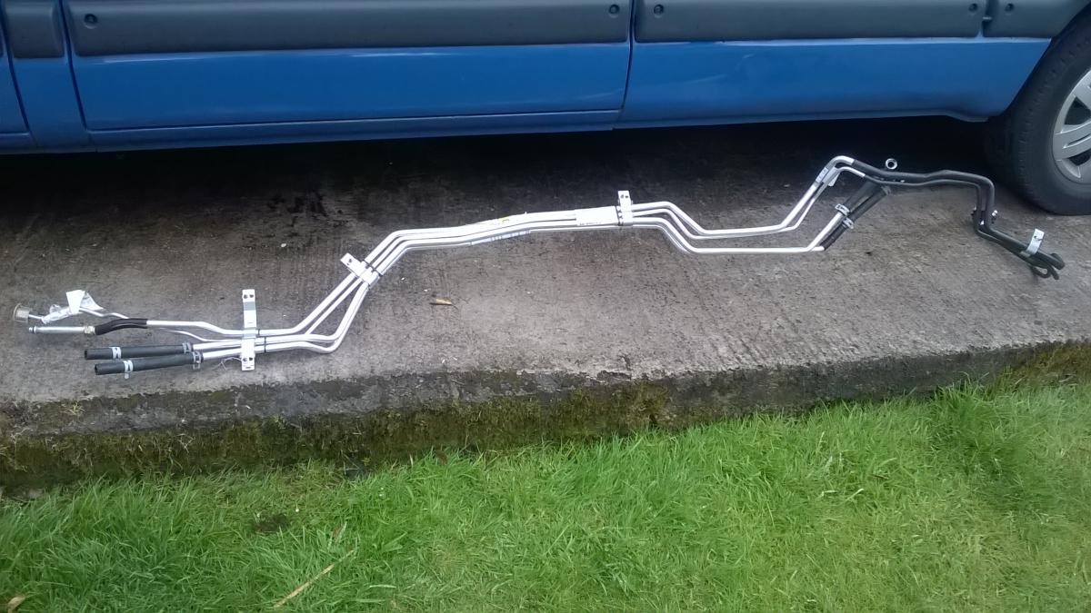

Yes I had mine fixed last year - the same job exactly.
I found one guy at a breakers who had them, for £90, and the courier destroyed them on the way to me, didn't actually bother dropping them off, left a card and returned to sender, in half.
Contact the spares guys at Pentagon Barnsley,not all that far from you I guess, for a very important collection! I got the set of pipes from them. 01226 323050
They emailed me the parts picure to confirm it was what we needed, extremely helpful guys.
All 4 - Air Con and heater - from rear to drivers foot area, were £165!! Had to order in but they only took 3 days.
For the Stow n Go 2005  The part number is K05189882AA, and rather strangely it's called a "cable harness". That info is from the parts sticker from the pipes - so no doubts.
They are rather long, and very awkward to fit. the front nuts were a bugger to undo, my AC guy couldn't do it, in a garage with all the tools, so I used the heating engineer method and very carefully cut the nut at each side and split it, only aluminium. Took me half an hour under the car on the floor. So don't believe them if "it can't be done".
The problem with blanking any refrigerant pipes off is the danger of the oil collecting at that point and then not lubricating the compressor.
