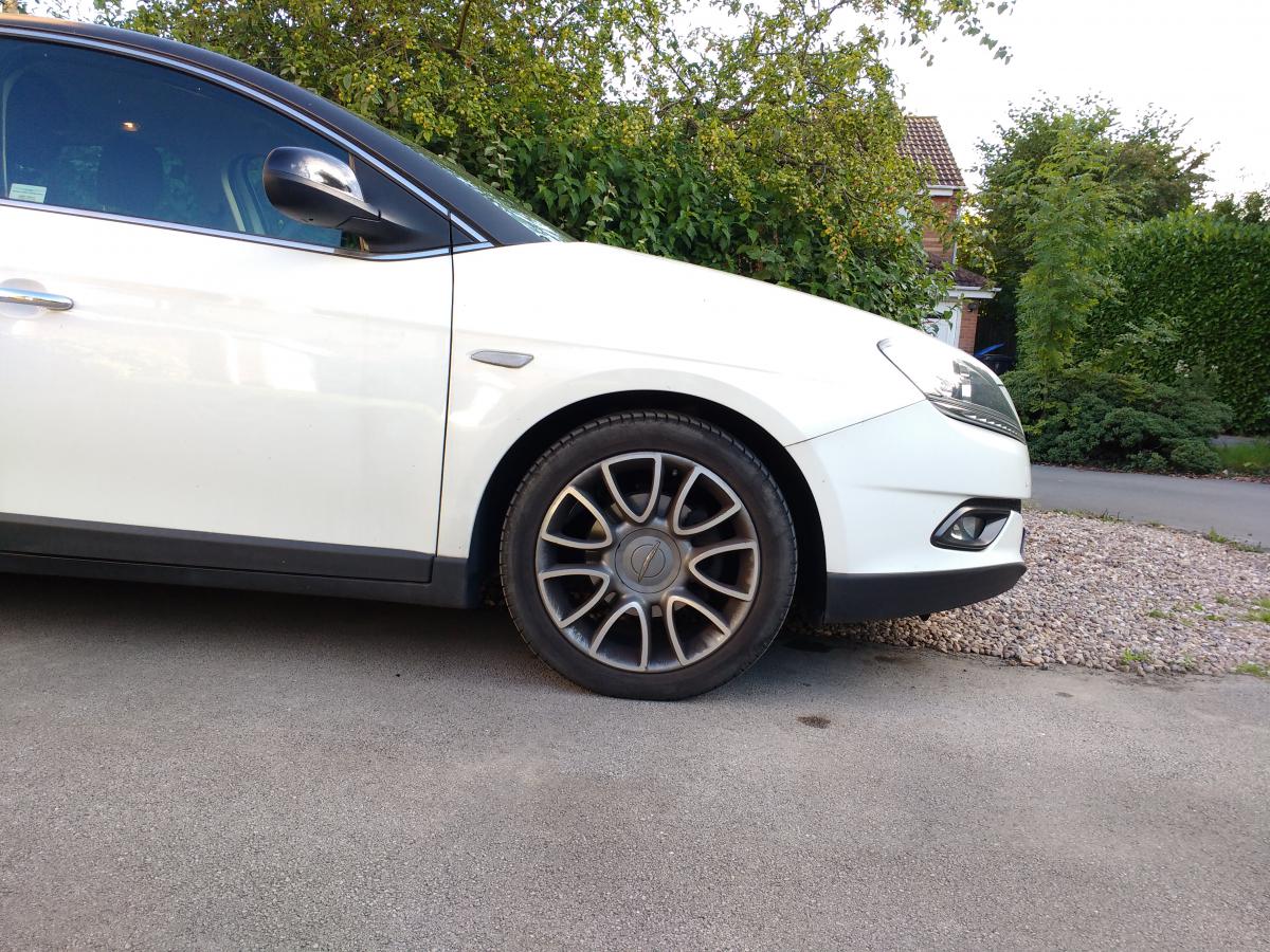

0 Dido Posted September 1, 2017 Report Share Posted September 1, 2017 I have Eibachs on my Coupe - look terrific and give it the stance it should've had from the factory. Wouldn't mind seeing a pic or two of a lowered Delta Flav? Quote Link to comment Share on other sites More sharing options...
0 Dido Posted September 1, 2017 Report Share Posted September 1, 2017 I have Eibachs on my Coupe - look terrific and give it the stance it should've had from the factory. Wouldn't mind seeing a pic or two of a lowered Delta Flav? Nello 1 Quote Link to comment Share on other sites More sharing options...
0 Nello Posted September 1, 2017 Report Share Posted September 1, 2017 (edited) Nice one mate - does not actually look like its lowered too much? Edited September 1, 2017 by Nello Quote Link to comment Share on other sites More sharing options...
0 Dido Posted September 2, 2017 Report Share Posted September 2, 2017 Nice one mate - does not actually look like its lowered too much? Quote Link to comment Share on other sites More sharing options...

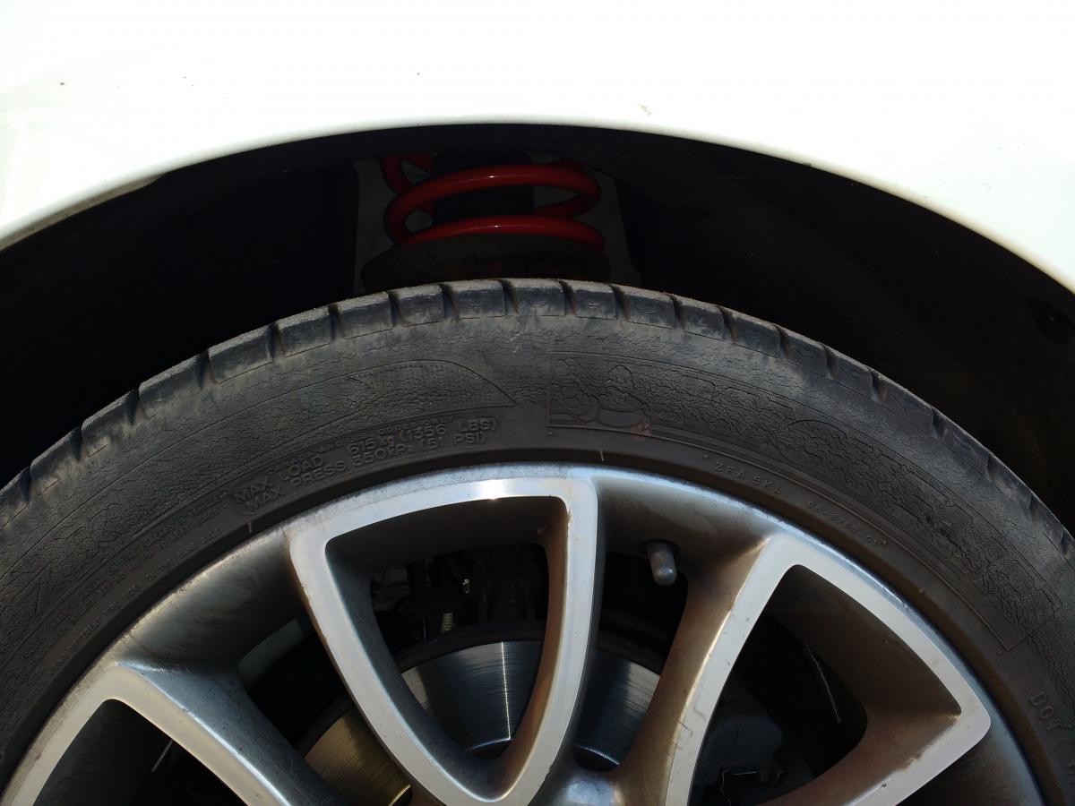

0 Dido Posted September 2, 2017 Report Share Posted September 2, 2017 Definitely a better ride, didn't bother me much on speed humps. I actually didn't notice the 30 mm lowering until I was stepping out of the car and noticed the lower threshold. At least it's back on the tarmac. Quote Link to comment Share on other sites More sharing options...

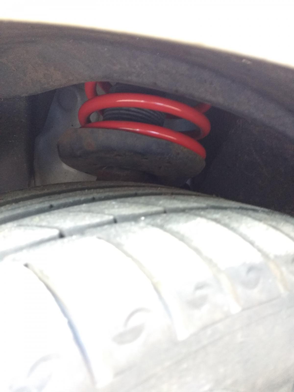

0 Dido Posted January 5, 2018 Report Share Posted January 5, 2018 A better solution is to fit German ebach Pro coils that are manufactured specially for the delta, the set of 4 would cost just under 200 quids.I had this fitted without any problems, labour should be about another 100 quids max. You need to order these yourself online and get them to your local garage to be fitted. Being a sporty coils, they will lower the car by 30 mm, which gives a more stable ride but no problems with potholes. All 4 need to be changed. Much better than the 900 quids theft from the dealer. https://www.rtecshop.com/products.php?do=viewprod&product_id=45965https://m.autodoc.co.uk/eibach/1930655?grmk=1&gclid=Cj0KCQiA4bzSBRDOARIsAHJ1UO6R6VnvOmNRUxNDHbJjEcPqCTxneJuShBS4ipkCRo5V851R1wzdZb4aAhMeEALw_wcB And hang on to your Delta Nello 1 Quote Link to comment Share on other sites More sharing options...
