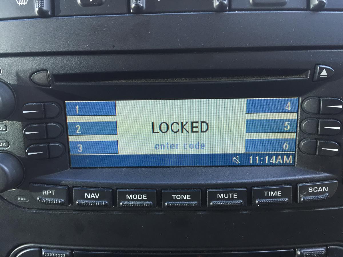

Hi, every time the ignition is turned off and on my radio looses all its settings. It's really starting to frustrate me but can't find a solution. I don't have the radio code either. It isn't one which has memory seats which I have read about online. Any ideas?

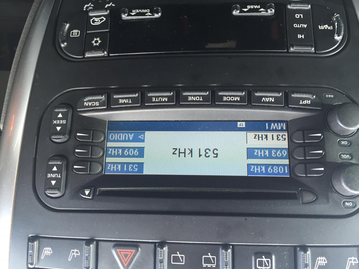

So I purchased the said battery. And I'm still having the same issues. It is not saving anything I put in to the unit ie audio > FM fix > save a radio station > turn off ignition > turn on ignition and then it goes back to the first screen which is this picture.
