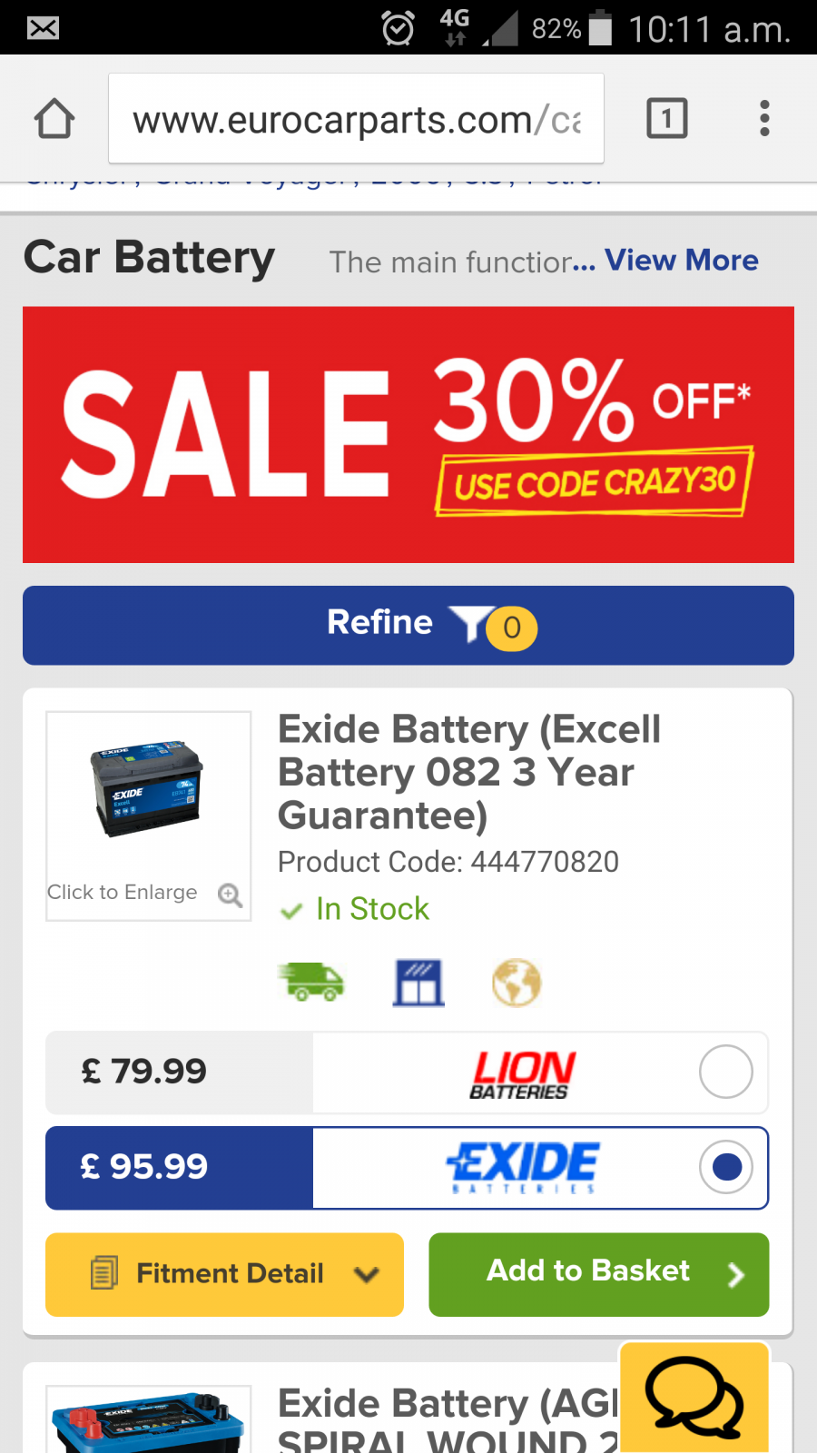

I went for 096R Enduroline Car Battery 74Ah 690CCA direct from Tayna Batteries (www.tayna.co.uk) as it was the best price I could get (£68 inc delivery).
Ta ∀ndy Brown.
Exide in my opinion are the worlds best high street maker for domestics, indeed they make Merc & BMW OEM branded batteries along with my preferred Varta F21 which is 80aH and 800CCA. The 082 Exide is 74aH and 680CCA when brand new. ∀ndy Brown is right, once the battery is eliminated the radio-bodge is always the next level in the menu of diagnostics. Most decent pro diagnostics can read most of the radio without dismantling anything, indeed there's a whole section in the scanners for this including manufacturers 'U' codes, those without access are going to have to go old school and a multimeter. The Yuasa on Liam89's car is an excellent battery but its knackkered and undercharging almost always down to sulphated plates, low voltage as we all know can play havoc with onboard electronics, and the fuel injection and ignition systems. I always understood there were 2 general rules :
