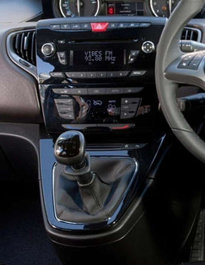

vas Posted March 15, 2024 Report Share Posted March 15, 2024 My wife has a 0.9ltr twinair Ypsilon 2011. It has developed a problem with the heater which blows hot even when the heater is set to low. (Pic shows type of heater controls in her car). Has anyone had this problem? Does anyone know how to rectify it? I would appreciate any suggestions as to where to start looking for the cause. Quote Link to comment Share on other sites More sharing options...
0 Deltamike Posted March 22, 2024 Report Share Posted March 22, 2024 Unfortunately Fiat use plastic gears to control the HVAC systems on their cars, over time the plastic becomes brittle and breaks. The usual symptoms therefore are a lack of control of air flow direction or temperature. Fiat sell a repair kit of parts, look online for 77365657 or 77364376. The last one fixed my Delta (direction not temperature), I have to admit I’m not 100% on which one is best for the Ypsilon though. A Fiat/Alfa dealer or good independent with access to Eper might be able to help. Quote Link to comment Share on other sites More sharing options...
