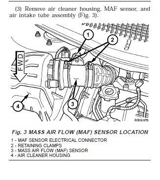

scotsholme Posted January 14, 2024 Report Share Posted January 14, 2024 Where is the maf sensor located on a 2.5 2006 2.5crd Quote Link to comment Share on other sites More sharing options...
0 RichardM Posted January 15, 2024 Report Share Posted January 15, 2024 located after the air cleaner (o/s engine ) -> see dwg. Quote Link to comment Share on other sites More sharing options...
0 scotsholme Posted January 16, 2024 Author Report Share Posted January 16, 2024 Thank you that helps a lot Quote Link to comment Share on other sites More sharing options...
