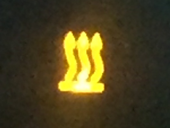

Hi everyone. Just got myself a grand voyager at the weekend and he family all love it .. But already a warning light has come on ,, I have no handbook so don't know what it means . Can anyone help me what it is ?? Thanks.
It's a 2.8 crd executive xs model auto
Also does anyone have a pdf version of the handbook or know where I can get one ?? Tyvm

Hi. I copied this off another post for you.
This light is only used for DIESEL ENGINE powered vehicles.
Vehicles equipped with the diesel engine are equipped with a supplemental cabin heater. This cabin heater is mounted under the vehicle and operates similar to an oil fired furnace. The heater burns small amounts of fuel to provide additional heat to the coolant. Coolant is routed from the engine, to the supplemental cabin heater and then to the front heater core. This provides additional heat to the passenger compartment. The supplemental cabin heater system is interfaced to the vehicles on-board computer systems and the scantool diagnostics.
The supplemental cabin heater has an electronic control module that monitors the heat output of the heater. The cabin heater operates at full load (5 kW), half load or idle mode (no additional heat) depending on engine coolant temperature.
When ambient temperatures are lower than 15° C (60° F), the supplemental cabin heater automatically operates once each ignition cycle for five minutes. This assures a good fuel supply is always present for the supplemental cabin heater.

The Webasto light should come on at will or at all only if the heater is switched on and on auto digital temp. Example it will never come on even @ -20 °C if the heating is switched off. Best of luck.
